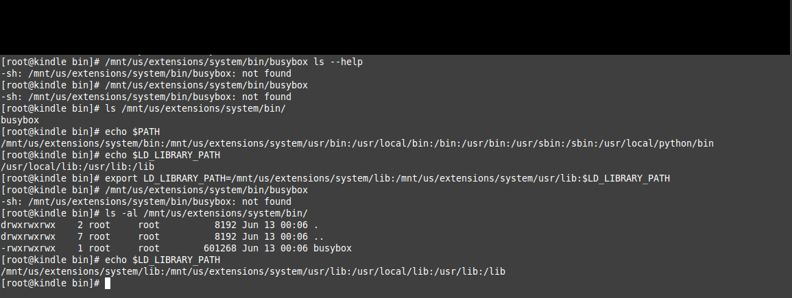

I believe "not found" in this case refers to "cant be run." Ill double check
Clear the LD_LIBRARY_PATH thingy!
The whole point of this exercise is that you do not need anything set in LD_LIBRARY_PATH.
That information is now moved into the elf format binaries.
(AH, both of them, there are only two at the moment, busybox and lua).
Run either of those (the ones stored on /mnt/us/extensions/system/*) and everything else is "automagically", dynamically linked with the hard float libraries.
Run either of those (stored in the Amazon image) and everything is "automagically", dynamically linked with the soft float libraries.
Neat? Right?
(In fact, /mnt/us/extensions/system/* tree may hold **both** types of binaries - at the same time.)
With this set-up, it should be possible to take an application binary packaged for Debian/Jessie, open, diddle elf headers, then drop into /mnt/us/extensions/system/* and it will "just work".

PW:
[root@kindle root]# unset LD_LIBRARY_PATH
[root@kindle root]# echo $LD_LIBRARY_PATH
[root@kindle root]# /mnt/us/extensions/system/bin/busybox
-sh: /mnt/us/extensions/system/bin/busybox: not found
I'll go test it on something else.
hhmm
KT:
[root@kindle root]# LD_DEBUG=libs /mnt/us/extensions/system/bin/busybox ls --help
erm...[root@kindle root]# LD_DEBUG=libs /mnt/us/extensions/system/usr/bin/lua
-sh: /mnt/us/extensions/system/usr/bin/lua: not found
I did manage to get a:
uname: error while loading shared libraries: ld-linux-armhf.so.3: cannot open shared object file: No such file or directory
lipc-set-prop: error while loading shared libraries: ld-linux-armhf.so.3: cannot open shared object file: No such file or directory
/usr/bin/lipc-set-prop: error while loading shared libraries: ld-linux-armhf.so.3: cannot open shared object file: No such file or directory
killall: error while loading shared libraries: ld-linux-armhf.so.3: cannot open shared object file: No such file or directory
out of my login script...
OTHER KT: Same. hmmm... *scratches head*

[root@kindle lib]# LD_DEBUG=libs grep -v
SNIP
11573:	find library=ld-linux-armhf.so.3 [0]; searching
     11573:	 search path=/mnt/us/extensions/system/lib:/usr/local/lib/tls/v7l/neon/vfp:/usr/local/lib/tls/v7l/neon:/usr/local/lib/tls/v7l/vfp:/usr/local/lib/tls/v7l:/usr/local/lib/tls/neon/vfp:/usr/local/lib/tls/neon:/usr/local/lib/tls/vfp:/usr/local/lib/tls:/usr/local/lib/v7l/neon/vfp:/usr/local/lib/v7l/neon:/usr/local/lib/v7l/vfp:/usr/local/lib/v7l:/usr/local/lib/neon/vfp:/usr/local/lib/neon:/usr/local/lib/vfp:/usr/local/lib		(LD_LIBRARY_PATH)
     11573:	  trying file=/mnt/us/extensions/system/lib/ld-linux-armhf.so.3
     11573:	  trying file=/usr/local/lib/tls/v7l/neon/vfp/ld-linux-armhf.so.3
     11573:	  trying file=/usr/local/lib/tls/v7l/neon/ld-linux-armhf.so.3
     11573:	  trying file=/usr/local/lib/tls/v7l/vfp/ld-linux-armhf.so.3
     11573:	  trying file=/usr/local/lib/tls/v7l/ld-linux-armhf.so.3
     11573:	  trying file=/usr/local/lib/tls/neon/vfp/ld-linux-armhf.so.3
     11573:	  trying file=/usr/local/lib/tls/neon/ld-linux-armhf.so.3
     11573:	  trying file=/usr/local/lib/tls/vfp/ld-linux-armhf.so.3
     11573:	  trying file=/usr/local/lib/tls/ld-linux-armhf.so.3
     11573:	  trying file=/usr/local/lib/v7l/neon/vfp/ld-linux-armhf.so.3
     11573:	  trying file=/usr/local/lib/v7l/neon/ld-linux-armhf.so.3
     11573:	  trying file=/usr/local/lib/v7l/vfp/ld-linux-armhf.so.3
     11573:	  trying file=/usr/local/lib/v7l/ld-linux-armhf.so.3
     11573:	  trying file=/usr/local/lib/neon/vfp/ld-linux-armhf.so.3
     11573:	  trying file=/usr/local/lib/neon/ld-linux-armhf.so.3
     11573:	  trying file=/usr/local/lib/vfp/ld-linux-armhf.so.3
     11573:	  trying file=/usr/local/lib/ld-linux-armhf.so.3
/SNIP
grep: error while loading shared libraries: ld-linux-armhf.so.3: cannot open shared object file: No such file or directory
[root@kindle lib]# LD_DEBUG=libs /mnt/us/extensions/system/bin/busybox
[root@kindle lib]# cd /mnt/us/extensions/system/bin
[root@kindle bin]# LD_DEBUG=libs ./busybox
-sh: ./busybox: not found
seems to not be finding it or not finding something it can use anyhow.

Hmm...
On my K5-Paperwhite (with the libraries I thought I shipped):
      5772:     find library=libc.so.6 [0]; searching
      5772:      search path= too long, not interesting:
:/mnt/us/extensions/system/bin/../usr/lib            (RUNPATH from file ./busybox)
      5772:       trying file=/mnt/us/extensions/system/bin/../lib/tls/v7l/neon/vfp/libc.so.6
      5772:       trying file=/mnt/us/extensions/system/bin/../lib/tls/v7l/neon/libc.so.6
      5772:       trying file=/mnt/us/extensions/system/bin/../lib/tls/v7l/vfp/libc.so.6
      5772:       trying file=/mnt/us/extensions/system/bin/../lib/tls/v7l/libc.so.6
      5772:       trying file=/mnt/us/extensions/system/bin/../lib/tls/neon/vfp/libc.so.6
      5772:       trying file=/mnt/us/extensions/system/bin/../lib/tls/neon/libc.so.6
      5772:       trying file=/mnt/us/extensions/system/bin/../lib/tls/vfp/libc.so.6
      5772:       trying file=/mnt/us/extensions/system/bin/../lib/tls/libc.so.6
      5772:       trying file=/mnt/us/extensions/system/bin/../lib/v7l/neon/vfp/libc.so.6
      5772:       trying file=/mnt/us/extensions/system/bin/../lib/v7l/neon/libc.so.6
      5772:       trying file=/mnt/us/extensions/system/bin/../lib/v7l/vfp/libc.so.6
      5772:       trying file=/mnt/us/extensions/system/bin/../lib/v7l/libc.so.6
      5772:       trying file=/mnt/us/extensions/system/bin/../lib/neon/vfp/libc.so.6
      5772:       trying file=/mnt/us/extensions/system/bin/../lib/neon/libc.so.6
      5772:       trying file=/mnt/us/extensions/system/bin/../lib/vfp/libc.so.6
      5772:       trying file=/mnt/us/extensions/system/bin/../lib/libc.so.6
      5772:
      5772:
      5772:     calling init: /mnt/us/extensions/system/bin/../lib/libc.so.6
      5772:
      5772:
      5772:     calling init: /usr/lib/libenvload.so
      5772:
      5772:
      5772:     initialize program: ./busybox
      5772:
      5772:
      5772:     transferring control: ./busybox
      5772:
BusyBox v1.22.1 (2014-06-11 02:23:01 CDT) multi-call binary.
BusyBox is copyrighted by many authors between 1998-2012.
Licensed under GPLv2. See source distribution for detailed
copyright notices.
Usage: busybox [function [arguments]...]
   or: busybox --list[-full]
   or: busybox --install [-s] [DIR]
   or: function [arguments]...
        BusyBox is a multi-call binary that combines many common Unix
        utilities into a single executable.  Most people will create a
        link to busybox for each function they wish to use and BusyBox
        will act like whatever it was invoked as.
Currently defined functions:
        [, [[, addgroup, adduser, ar, arping, ash, awk, basename, blkid, bunzip2, bzcat, cat, catv, chattr, chgrp, chmod,
        chown, chroot, chrt, chvt, cksum, clear, cmp, cp, cpio, crond, crontab, cut, date, dc, dd, deallocvt, delgroup,
        deluser, devmem, df, diff, dirname, dmesg, dnsd, dnsdomainname, dos2unix, du, dumpkmap, echo, egrep, eject, env,
        ether-wake, expr, false, fdflush, fdformat, fgrep, find, fold, free, freeramdisk, fsck, fstrim, fuser, getopt, getty,
        grep, gunzip, gzip, halt, hdparm, head, hexdump, hostid, hostname, hwclock, id, ifconfig, ifdown, ifup, inetd, init,
        insmod, install, ip, ipaddr, ipcrm, ipcs, iplink, iproute, iprule, iptunnel, kill, killall, killall5, klogd, last,
        less, linux32, linux64, linuxrc, ln, loadfont, loadkmap, logger, login, logname, losetup, ls, lsattr, lsmod, lsof,
        lspci, lsusb, lzcat, lzma, makedevs, md5sum, mdev, mesg, microcom, mkdir, mkfifo, mknod, mkswap, mktemp, modprobe,
        more, mount, mountpoint, mt, mv, nameif, netstat, nice, nohup, nslookup, od, openvt, passwd, patch, pidof, ping,
        pipe_progress, pivot_root, poweroff, printenv, printf, ps, pwd, rdate, readlink, readprofile, realpath, reboot, renice,
        reset, resize, rm, rmdir, rmmod, route, run-parts, runlevel, sed, seq, setarch, setconsole, setkeycodes, setlogcons,
        setserial, setsid, sh, sha1sum, sha256sum, sha3sum, sha512sum, sleep, sort, start-stop-daemon, strings, stty, su,
        sulogin, swapoff, swapon, switch_root, sync, sysctl, syslogd, tail, tar, tee, telnet, test, tftp, time, top, touch, tr,
        traceroute, true, tty, udhcpc, umount, uname, uniq, unix2dos, unlzma, unxz, unzip, uptime, usleep, uudecode, uuencode,
        vconfig, vi, vlock, watch, watchdog, wc, wget, which, who, whoami, xargs, xz, xzcat, yes, zcat
      5772:
      5772:     calling fini: ./busybox [0]
      5772:
      5772:
      5772:     calling fini: /usr/lib/libenvload.so [0]
      5772:
[root@kindle bin]#
Note: There is no "grep -v" in the shipped package -
Your trace shows it not found in the hard-float package and is then searching for the soft-float version (which should have worked - but I didn't test it).
The only thing in the shipped package in */bin is busybox (one (1) file).
Aw, so!
Did you: rm -fr /mnt/us/extensions/system before you copied in the new hard-float stuff? (mine was empty)
There may be a conflict with what you already had in there.
Or with alias'es set-up in your root environment (mine had none).
Do (still) have root's profile set-up with an alias grep="something evil" ??

[root@kindle root]# ls -l /mnt/us/extensions/system/bin/busybox
-rwxr-xr-x    1 root     root        572596 Oct 19 13:08 /mnt/us/extensions/system/bin/busybox
[root@kindle root]# date
Fri Oct 19 13:18:46 CEST 2012
[root@kindle root]# cd /mnt/us/extensions/system/bin
[root@kindle bin]# ./busybox
[root@kindle bin]# ls -l ./busybox
-rwxr-xr-x 1 root root 572596 Oct 19 13:08 ./busybox
[root@kindle root]#

If that helps, that's what happens when the kernel can't even run the binary (wrong arch, possibly fatally wrong CPU tuning, although that should SIGILL instead).
armhf
