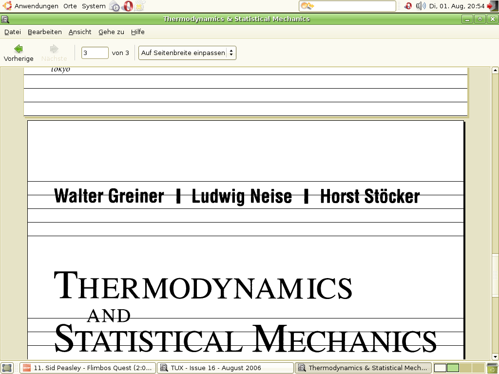

I have a lot of djvu files, I converted one by printing it to pdf. Viewing this file on iLiad it badly disappointed: ugly black horizontal lines are visible are all-over. Have a look at attached pdf-file; I will post a picture tomorrow.
I found out: the pages in pdf file are split in several horizontal image parts. The viewer of iLiad shows between a split a black line.
This is a great bug.
Now I have to find a converter which converts all pages of a djvu file to an image format at once to get a clean pdf file.
i would say this is rather a PDF-Bug then the iLiads Software. Evince on Ubuntu doesnt like it either, obviously.

The problem is that you have created a "version 1.6 pdf", and xpdf, that is the program the iliad uses for displaying pdfs, imlements only up to version 1.5. b_k uses evince that is based around poppler, and poppler is xpdf converted into a library, so it has the same limitations.
If you are able to get a bunch of image files (one per page), using ImageMagick convert utility you can get a nice pdf (perhaps with a little of fidling to get the right scale factor) from those files. It's as simple as in (tested on Linux):
prompt> convert '*.jpg' result.pdf
If you have to scale the images:
prompt> convert -geometry 200% '*.jpg' result.pdf
NOTE: In the tests i've done, it doesn't seems to compress much the images, so watch out the resulting file size.

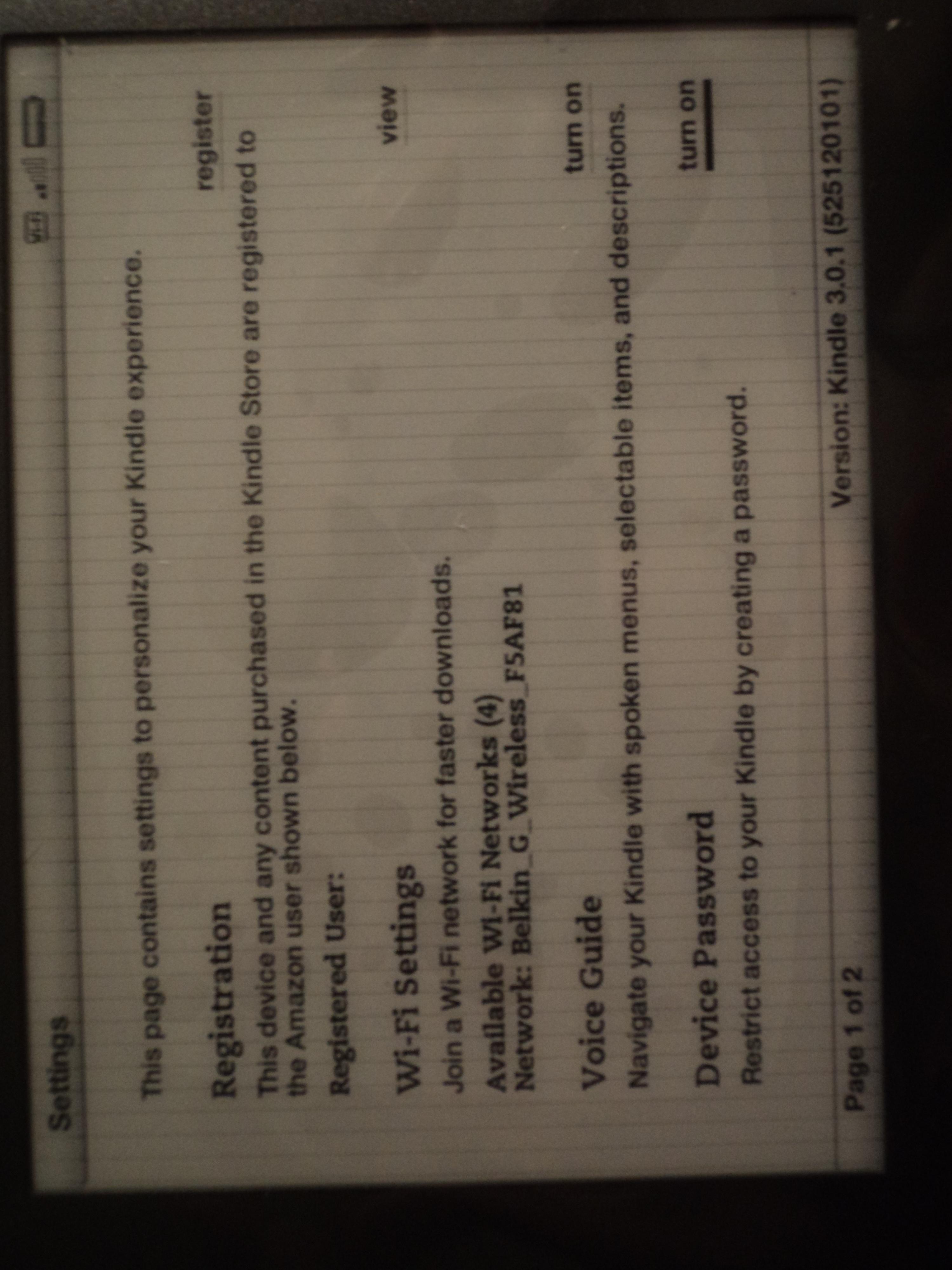

I am having these lines in the horizontal view of my new kindle 3 , is there a way to correct this?
Hi pragya105,
You, posted your message in the iRex-part of the forum, although the effect on the screen looks simular, I think you will get more response when posting in the Kindle-part of the forum.
Good luck with fixing your problem.
