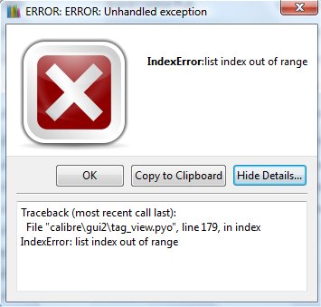

I upgraded this morning to 0.6.14, but I'm having problems importing files.
It's a weird error, which only happens when importing groups of files - not standalone ones. The program imports the files but gives a warning. It doesn't seem to be tied to a particular file format, and I wasn't able to reliably replicate it...
For example I was importing a LRF, 2 HTML and a PDF file. First time it imported them OK, but opened 6 waring popup windows. Then I deleted them from Calibre, re-imported the very same files again as a group, and everything went fine.
Here's the popup window which appears:
Ideas?
EDIT: I've been able to obtain the warning even adding a single file instead of a group of them - it just happens much more rarely with single books...

I've seen the same thing; when it happens, the book being imported has no source files. I assume that the list index is which format is being displayed [since calibre can store multiple formats of the same book], and when none are imported [this is the root cause], it's out of range immediately.

Will be fixed in next release.

I am getting this 100% of the time, any solution - roll back to a previous version ?

Rolling back seems the best solution if you have a lot of importing to do.

Same problem importing with newly installed 0.6.14
Reloading to 0.6.13 fixes problem
