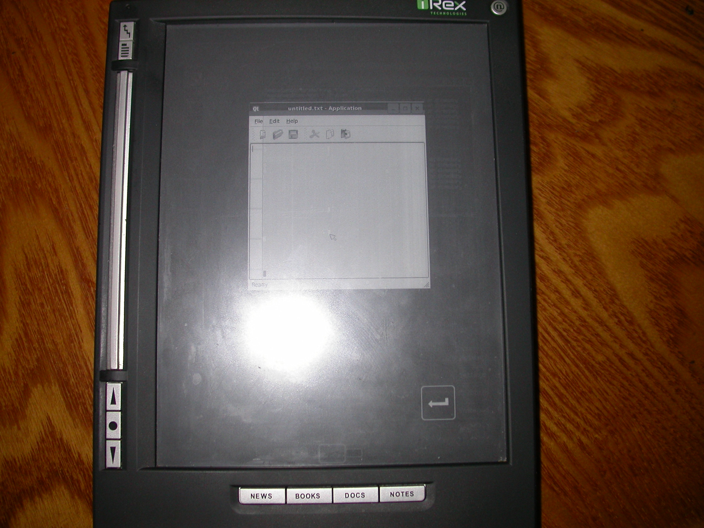

I just built QT/E 4.5.2 for iLiad and made it running on iLiad. It's Qt Embedded, not just Qt. Qt for iLiad is not a problem now, except not being able to respond to iLiad key-events. For me, I want Qt only because djvulibre and djview rely on Qt. QT/E provides more than Qt. QT/E does not need X, so theoretically, it should be more effective on iLiad. That's why I want to run QT/E on iLiad. If everything goes on, applications for Zaurus may be ported to iLiad by just re-compiling. Of course, the current contentlister and ipdf must be replaced (with what?) if X is removed from iLiad.
This is only a primitive start, and still far from working. I have lots of questions. Any advice or experience about tslib, keyboard, QT, QT/E, Zaurus should be helpful.
I built tslib downloaded from http://tslib.berlios.de/, and use this option to do configure:
./configure -opensource -nomake tools -nomake demos -nomake docs -nomake translations -qt-freetype -qt-mouse-tslib -no-qvfb -embedded arm -qt-kbd-tty -qt-kbd-usb
The attached image shows the result running a QT/E application. It's a small example bundled in QT/E package. All bundled examples are built and put in dir "examples" in the attached QT/E lilbs package. I leave them for people to try.
People who want to try can download the attached files. "QtEmbedded-4.5.2-arm.part1.rar" and "QtEmbedded-4.5.2-arm.part2.rar" are QT/E libs. qtedemo.rar is the demo program which should generate a screen just as the attached image.
To install:
1. unpack QT/E libs to MMC or CF. (I put it in MMC, so there will be a dir "QtEmbedded-4.5.2-arm" in /media/card)
2. cd /usr/local
3. mkdir Trolltech
4. cd Trolltech
5. ln -s /media/card/QtEmbedded-4.5.2-arm QtEmbedded-4.5.2-arm (you should modify "/media/card/QtEmbedded-4.5.2-arm" to fit your path if not unpacked to /media/card.)
6. unpack qtedemo.rar to anywhere and execute it from contentlister. Wait for several ten-seconds, you will see a screen just as the attached image.
7. Then you have to reset your iLiad because touch-screen is not working.

Some tiny tips:
If the desired screen does not show up after waiting for one or two minutes, try tap on the pagebar button. Don't tap the pagebar button too early.
tslib-0.0.so.0 in QtEmbedded-4.5.2-arm/lib can be removed if you do "ln -s /usr/lib/libts-1.0.so.0.0.0 /usr/lib/libts-0.0.so.0".
(Added: this sentence may be misleading. I meant tslib-0.0.so.0 in QtEmbedded-4.5.2-arm/lib is duplicated and you can remove it after you do "ln -s /usr/lib/libts-1.0.so.0.0.0 /usr/lib/libts-0.0.so.0".)
Added:
By the pagebar tapping action, I guess that on iLiad, even when a QT/E app does write screen data to fbramebuffer, iLiad stiil wait for a command to start drawing e-ink screen. It should be the most tough part. Maybe modifying Qt/E source code is required. I should take a look in the source code of liberdm.

My above experiement failed. My iLiad just reboot if I execute the above "run.sh".
The kill command should be
kill -STOP 285
IIRC, if you put first the PID, it sends a SIGTERM, terminating the X, and reboting the iliad in our case.
Another problem:
I think that I can't refresh screen manually by tapping on the pagebar icon after X server stopped. Can I?
Contentlister may be "paused" because of the stopped X. It depends on its internal implementation.

Can I manualy refresh the screen through command in ssh? I guess I have to create a program to do the task.
Added:
Is it possible to use xepdmgr as a shell command to manually refresh eink screen? I guess that "EinkUpdateFull(sEink *EinkParam, int UseTyping, int Fast)" in xepdmgr_einkfb.c is just what I need. It will make iLiad draw its eink screen based on data in framebuffer, right?
Added:
You can do what you are requesting using "displayMgrClient", it's a command-line tool from iRex to interface with the displayMgr. You have it already installed on your iliad .
For full refresh:
# /usr/bin/displayMgrClient
For typing refresh:
# /usr/bin/displayMgrClient -p
With "displayMgrClient -h" it shows some help text.
If you want to integrate that functionality directly into QTE, what it does is as simple as to send the text "!0,1,0" to UDP port localhost:50555 (original thread with this info).
Antartica is offline   Reply With Quote

Ah! Thanx. I think that MgrClient is just what I need.
