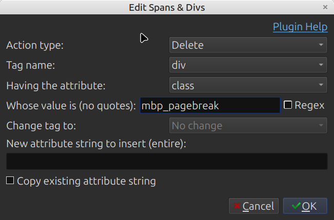

The easy and fastest way is to use Diaps Editing Toolbag plugin for the editor.
Name:	Screenshot from 2026-09-25 16-20-42.png
Attachment 226237
bernie
This looks fantastic, but I think I'm missing something - when I use it, it only affects the file I have open right then, not the whole book at once?
There is a 'tick box' setting on the icon ( click the arrow). Yours must currently be ticked: current file only
There isn't an arrow?
If I go to the plugin menu in the editor, I have
Convert CSS cm to em
Edit Span & Divs
Run Epubcheck
Smarten punctuation (the sequel)
The convert css one and the smarten punctuation one both have arrows, with a tick box. But the Edit Span & Divs one doesn't?
Edit Span & Divs
Run Epubcheck
That is interesting:
I had placed the Toolbag icon on the Toolbar (Preferences IN the Editor)and it has the arrow, where the Plugins menu does not offer the option
