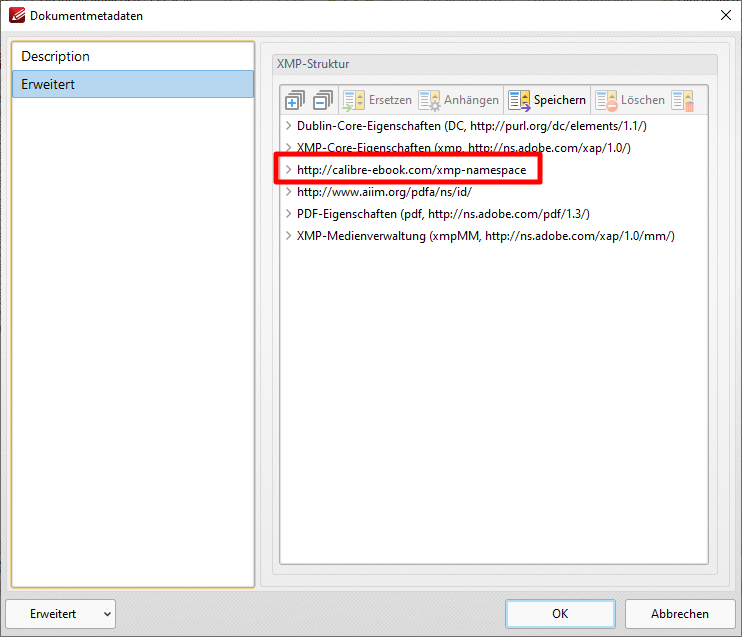

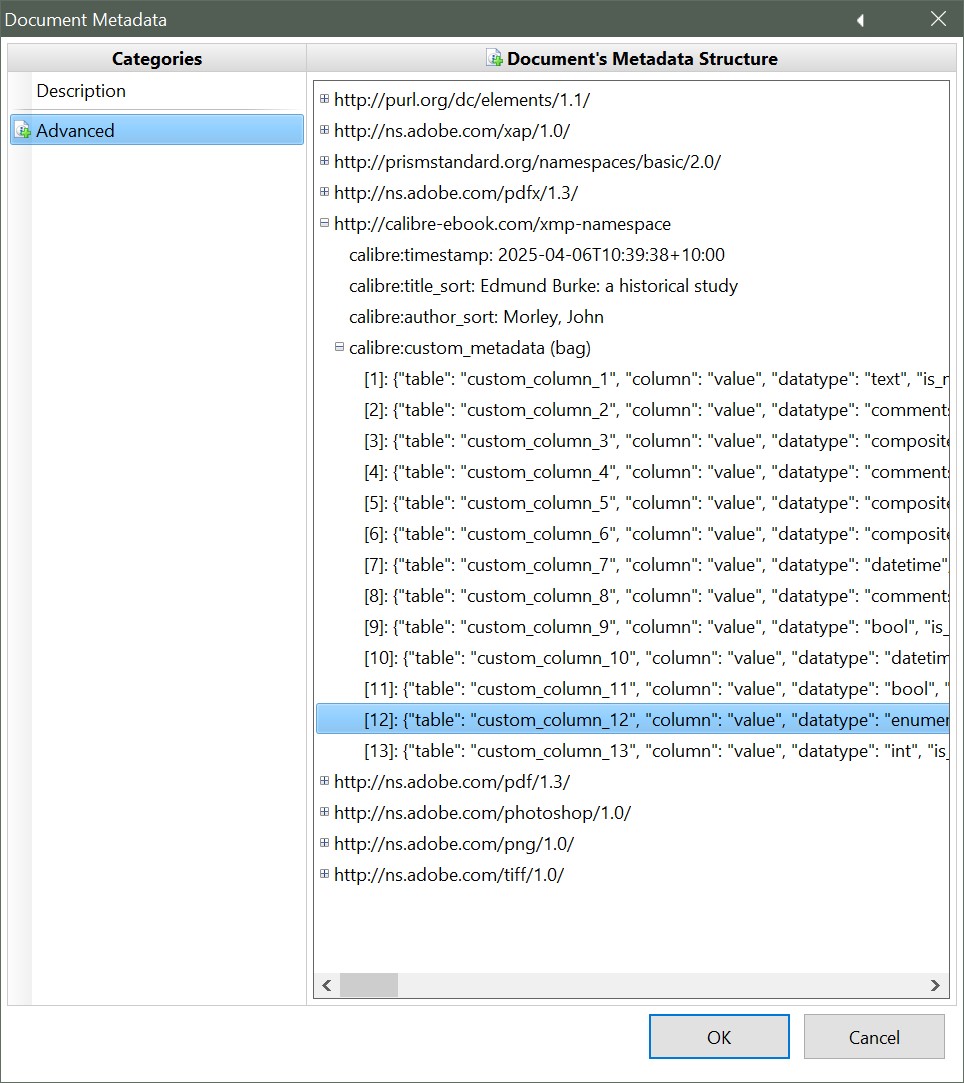

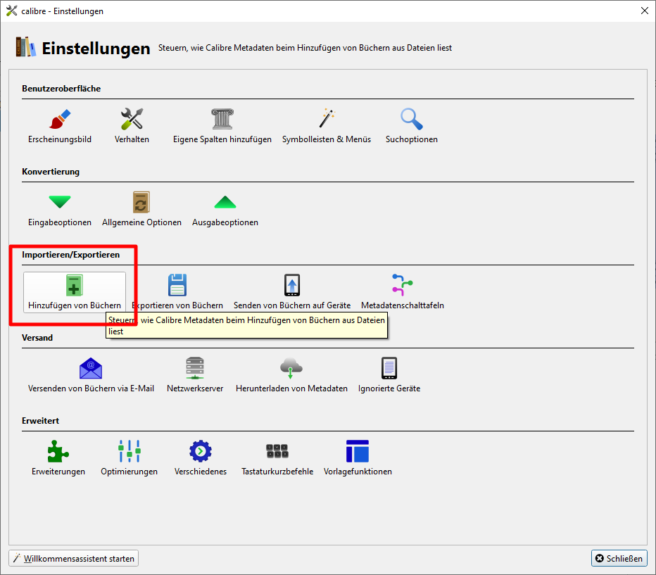

Hello,
thanks for the quick response. I think to explain more in detail
1. System: Windows 10 / Calibre 8.3.0
2. Testfile
https://www.uni-muenster.de/imperia/...ungen_pdfa.pdf

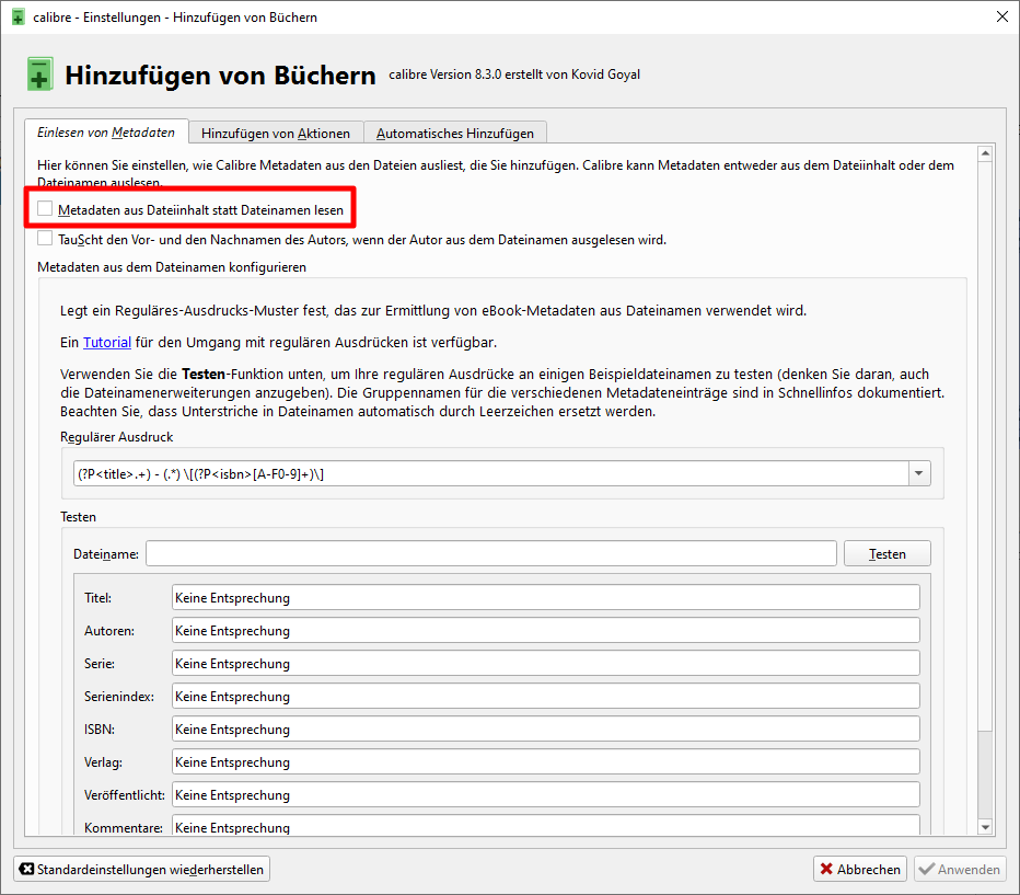

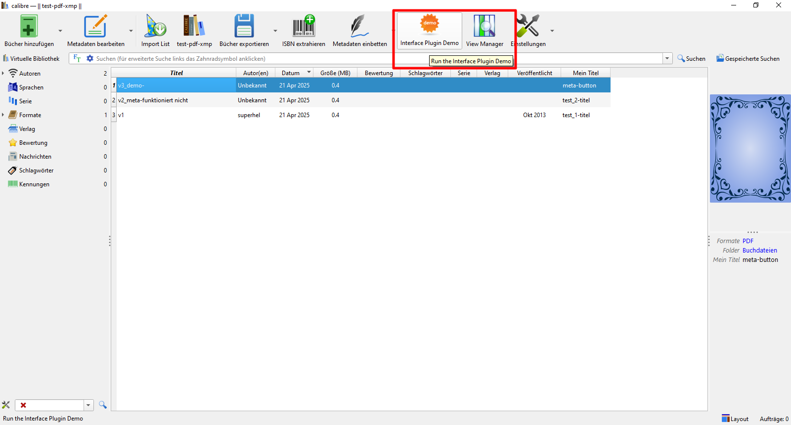

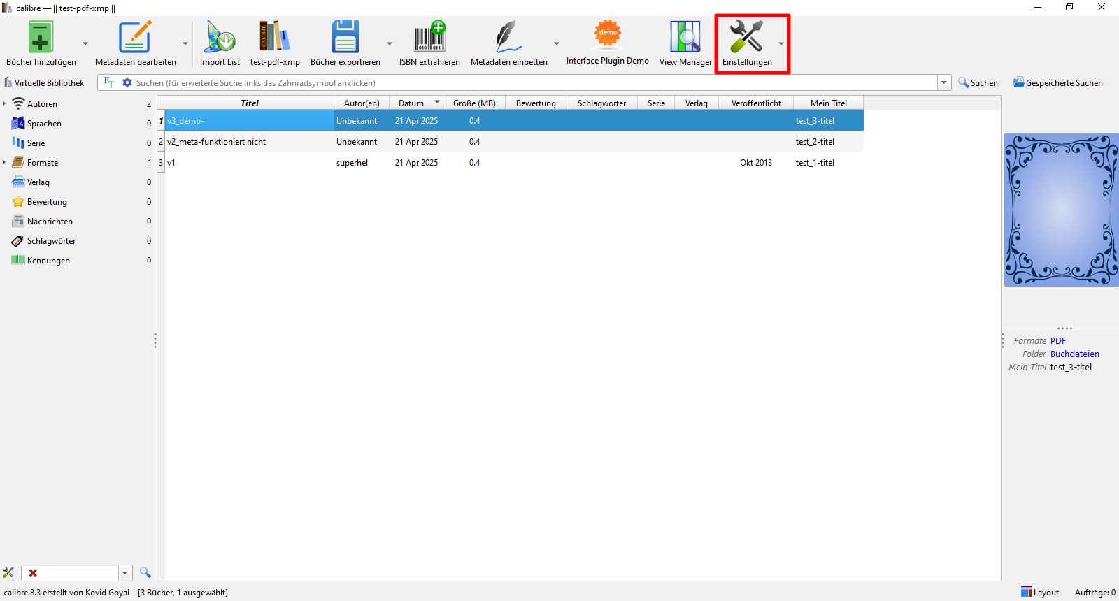

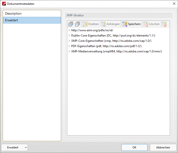

3. Preferences (see pictures 001,002,003)
4. Resluts with "Embed metadata" (004) and "Interface Demo Plugin" (005)
I also use PDF-XChange Editor.

Old 04-21-2025, 05:40 AM   #4
tribbleoo
tribbleoo began at the beginning.
Posts: 22
Join Date: Nov 2019
thx for quick response. i already answer, but i cant't find the post.
again.
System: Win10 / Calibre 8.3.0
Preferences: Pic 001,002,003
Results with PDF-XChange Editor: Pic 004,005

Old 04-21-2025, 05:46 AM   #6
tribbleoo
Posts: 22
Join Date: Nov 2019
Here the informations.
"Embed metadata" Pic004
"Update metadata in a book's files" Pic005
tribbleoo is offline   Reply With Quote
Old 04-21-2025, 05:53 AM   #7
Posts: 22,493
Karma: 32600658
Click the '>' at the start of the "http://calibre-ebook.com…" line in that last screen shot, or press the right arrow key. Ditto when you see the custom columns line.
Moderator Notice
For some reason best known to Mr Flay of Gormenghast Castle your replies were falling into the moderation bucket.
Old 04-21-2025, 06:14 AM   #8
tribbleoo
Posts: 22
Join Date: Nov 2019
Hello,
thx again.
i try to explain again.
- Download the example file from the link below (or any other pdf).
- Set the preferences like in Pics 001 - 003
- Drag&Drop the pdf in Calibre
- add some custom data
- push "Embed metadata" Button.
- check the metadata in pdf file
Can u realy confirm, that now already all custum data was written to the pdf file?
To your response:
yes thats the result, after i pushed the "Update metadata in a book's files" button and yes there are now the customs data inside the pdf. Yes i can explore that row with the > arrow.
But how about the result of the "Embed metadata" Button? Why they have different functions? I have think, that after push this button, there also will written the data directly to the pdf. As you see in Pic004, there are no "http://calibre-ebook.com…" line. Thats what i mean.
I hope i explaint it more clearly now.
thx

Old 04-21-2025, 06:36 AM   #9
tribbleoo
Posts: 22
Join Date: Nov 2019
Hello,
ok, here one more check with the calibre "ebook-meta" function.
1.
- check metadata from the file with "ebook-meta file.pdf"
- change in calibre the custum data
- check metadata again with "ebook-meta"
Result: no data changes
2.
- push "Update metadata in a book's files" button
Result: data changes
Whats the different?
thx and best regards

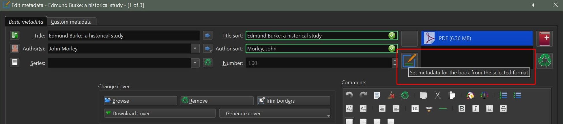

Where is the "Update metadata in a book's files" button. If you mean this button:
That button extracts the standard metadata from the format file and writes it to the database - it does NOT update the format files. Maybe the tooltip has been poorly translated.

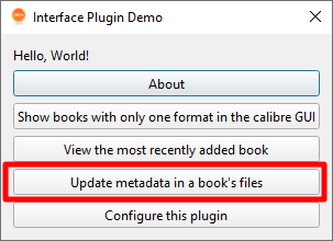

as i wrote in my first post, this button can found inside the sample from manual creating plugins.
https://manual.calibre-ebook.com/creating_plugins.html
https://calibre-ebook.com/downloads/...emo_plugin.zip
