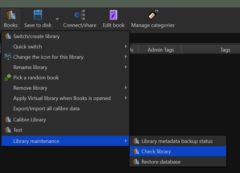

Run check library (stages 1. 2, and 3) on the Windows setup and correct any errors:
Name:	Screenshot 2024-12-09 123441.jpg
Then try using library on Linux.
