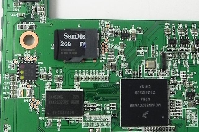

When you opened your Touch, did it have an internal µSD card? This has nothing to do with the external µSD card slot but would be mounted to the main board. See the attached image for an example.

Ah no it does not. I am looking at the board and it only has the external µSDcard. Thank you for clarifying that for me, so mine isn't the version that can be booted from the sd card. Ok so lesson learned, given that they don't service the Touch anymore do I just recycle the board?
