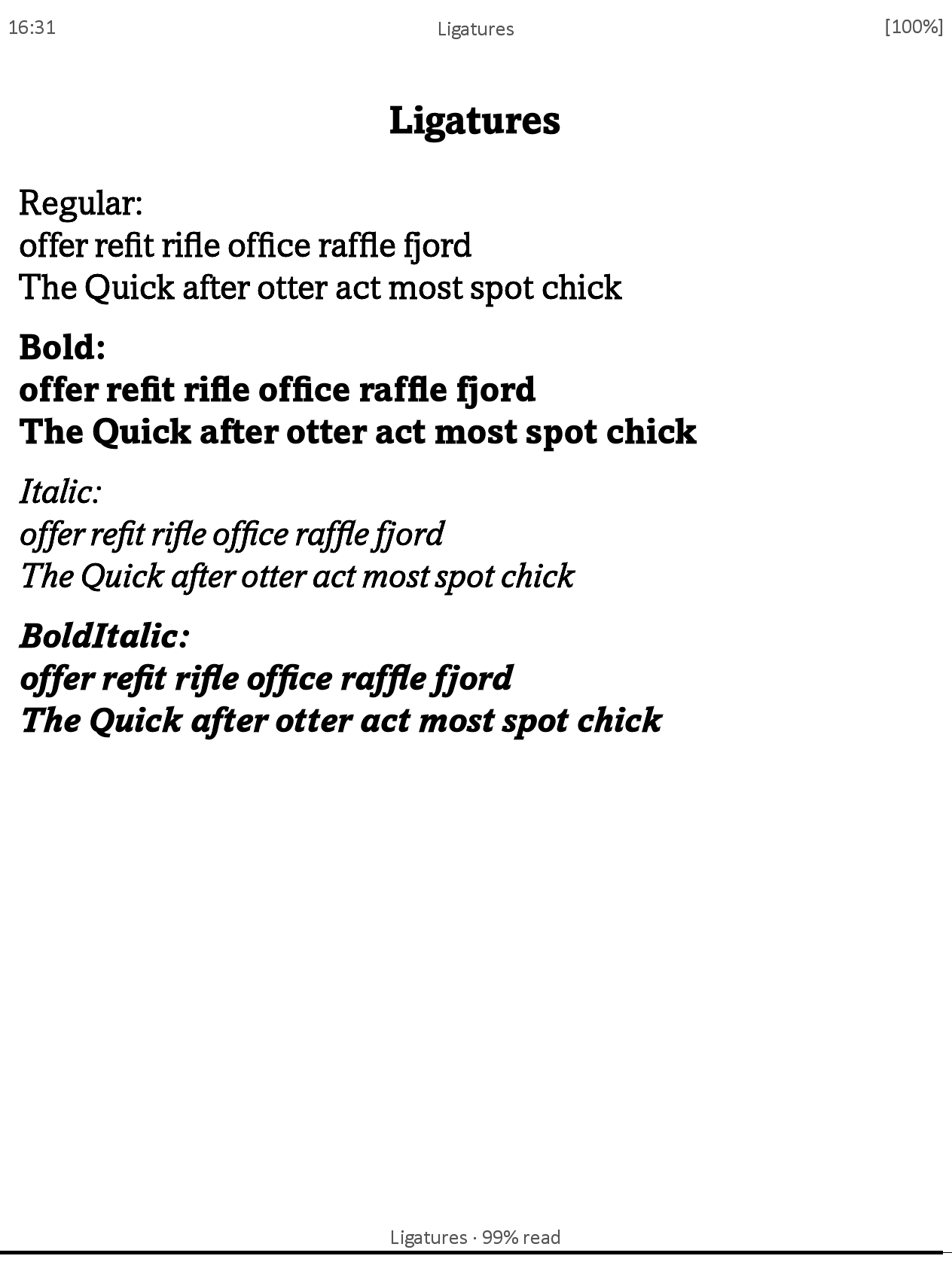

Optimizelegibility not working
(Not sure if I should post here or in dev subforum, sorry if I'm in the wrong place.) So, I just updated my device from 4.18 to the newest firmware out of curiosity and to get the Oxford dictionary hassle-free... but I had to give up my trusty text-rendering patch and instead move it to the config file, and I just can't. get it. to stick. To be clear, the right line is in there, in the correct section all right, and I am indeed looking at a kepub file - but no matter what typeface I choose, I can't see a single ligature in my book. What am I doing wrong?? Is there such a thing as a conflicting patch still? I tried editing the file with both Notepad++ and (in a moment of desperation) standard Windows Notepad, and I've power cycled the device...and my other config options are still displaying correctly. Am sad and almost want to go back to paper books for the weekend. Help :(

As far as I can tell, optimize legibility only enables kerning; I know of no way to enable ligatures in kepub files.

The old patch did, for typefaces that had old style kerning and ligatures enabled. I can't even tell if this setting enables one but not the other because it's such a jarring difference. But thank you for the answer, I'll experiment a little and revert back to the old fw if needed.

Optimize legibility should enable ligatures. I use ligatures in my kepubs and have for years.
I have switched to geometric precision as it keeps the ligatures and works better with spacing issues.
Under [Reading], paste:
webkitTextRendering=geometricPrecision
And I just use Notepad in Windows 10.
Close but no cigar. Glad to know they're still accessible somehow, but alas, my letters stay stubbornly separate. I don't know what I'm doing wrong.

Aren't ligatures part of the font itself? Maybe you're using a font that doesn't support them, or at least for which WebKit can't enable them?
Possible, of course. I could have done something to many of the side loaded ones trying to optimise them, too. But the stock iteration of Amasis has ligatures too and even they are not showing up.
Maybe list the patches you currently have enabled.
And just to make sure, in your .kobo folder, Kobo eReader.conf [Reading} section looks something like this?
[Reading]
bookProgressType=2
chapterProgressType=3
newBookProgressType=6
pageTurningOption=option3
readingAdobeShowPageNumbers=false
readingAlignment=
readingFontFamily=Literata Book
readingFontSharpness\Georgia=-0.06
readingFontSize=42
readingFontWeight\Georgia=0.11
readingLeftMargin=0
readingLineHeight=1
readingMenuState=
readingRightMargin=0
showFooter=true
showProgressBar=true
showTitle=false

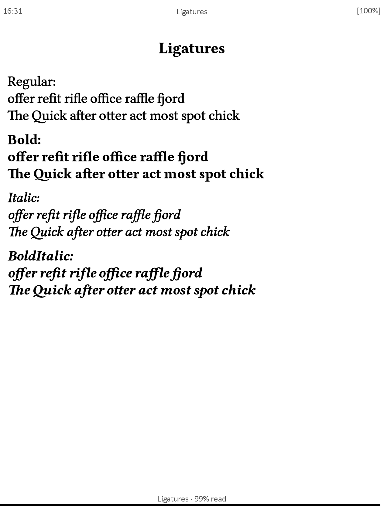

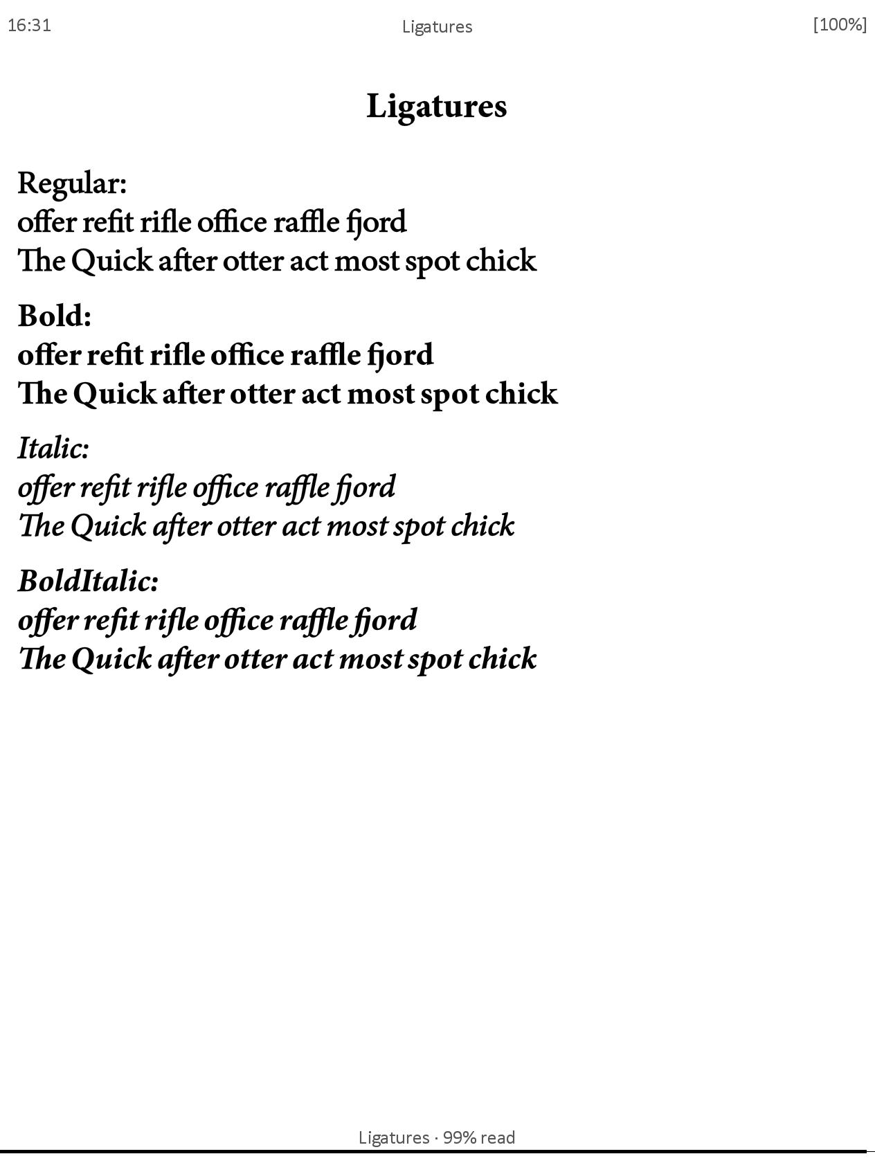

@Ansl,
Something doesn't add up, here. I've attached a 1-page test kepub and 3 screenshots from my Libra2 using 3 different fonts. As you can see, all fonts display at least some ligatures. Looking at the Amasis image I see ligatures for 'fi' and 'fl' but ligatures for 'ff', 'ffi', 'ffl' are not obvious in the Kobo built-in version of Amasis.
Rather than more aimless discussion please copy the attached kepub to your Kobo and compare what you see with Amasis (1st image) on your own device. Just copy the kepub using simple drag-drop with a USB connection. Don't use calibre or Dropbox or anything fancy as we don't want to introduce any unnecessary complications into what's happening.
ID:	198150   Click image for larger version
ID:	198151   Click image for larger version

Using JackieW's kepub on my Kobo Libra 2 with webkitTextRendering=optimizelegibility, I find:
Ligatures:
Amasis
Caecilia
Kobo Tsukushi Mincho
Malabar
No ligatures:
Avenir Next
Georgia
Gil Sans
Kobo UD Kakugo
Kobo Nickel
Open Dyslexic
Rakutan Sans
Rakutan Serif
RobertJSawyer is offline   Reply With Quote
