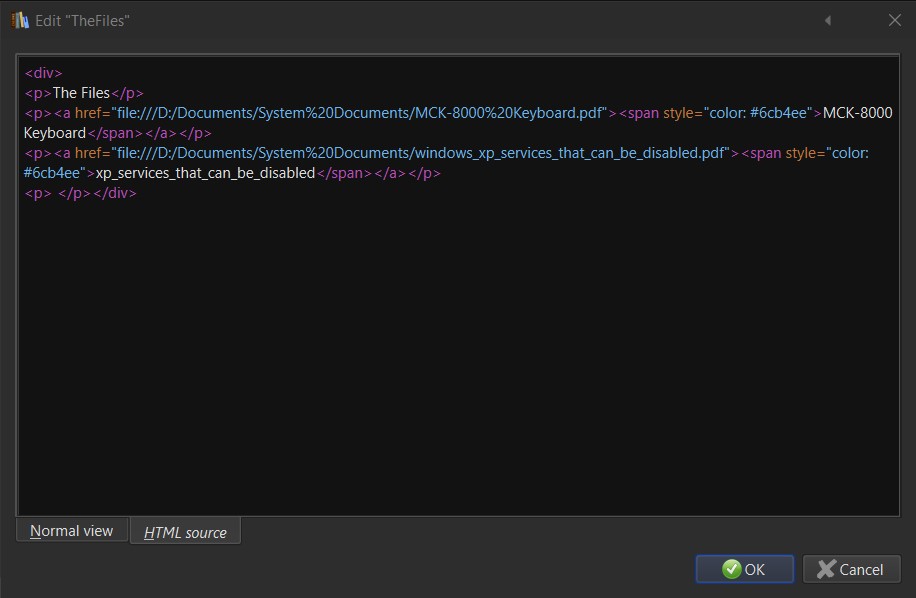

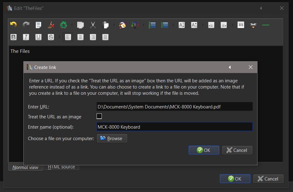

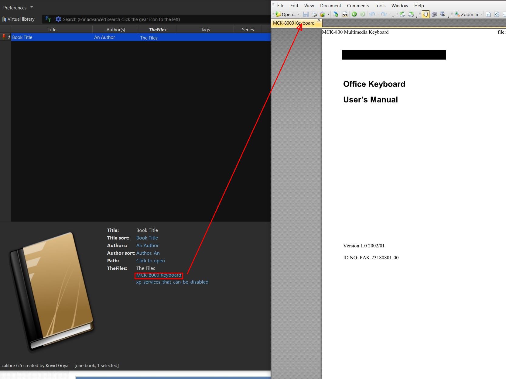

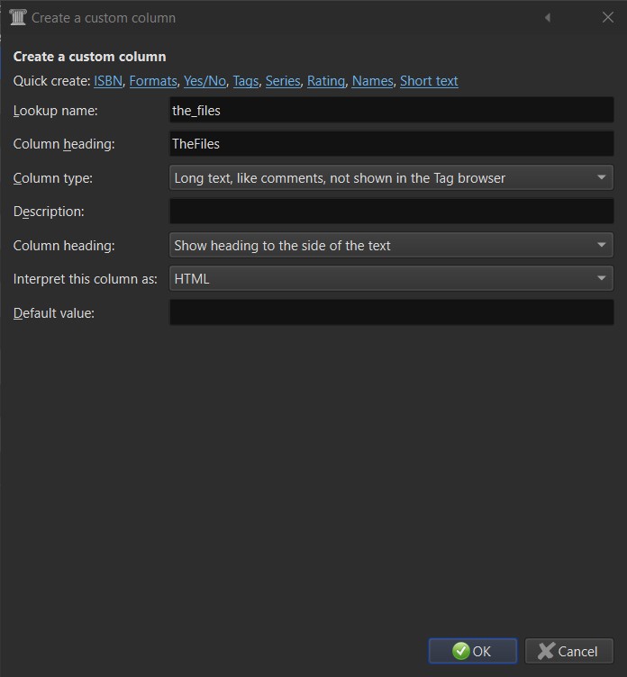

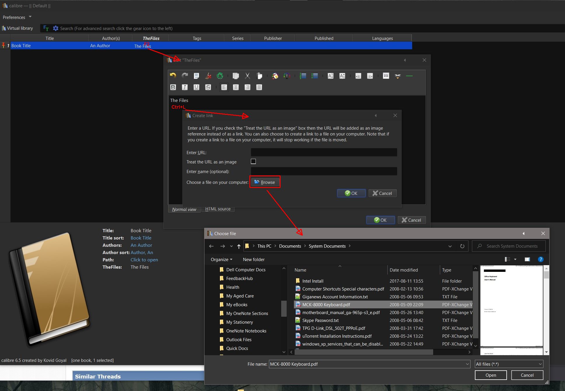

Have you considered putting file:\\ uris into a long text column via the insert link tool. See attachments
Downside: if you move or change a file name or location the links won't work any more.
BTW I could take issue with all your reasons for not storing content in the library.
