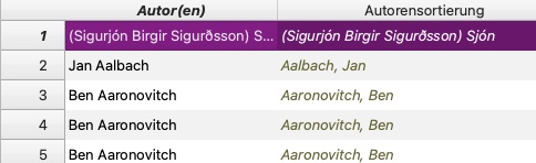

Sorting has a regression in v6.4... Sorting is same as Authors_sort which is clearly wrong.
See attached pic:
Name:	Bildschirmfoto 2022-09-03 um 09.47.21.jpg

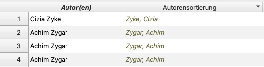

See the attached pics: I have changed sorting to "Author_sort"
Name:	Bildschirmfoto 2022-09-04 um 16.20.00.jpg
ID:	196271   Click image for larger version
Name:	Bildschirmfoto 2022-09-04 um 16.19.35.jpg

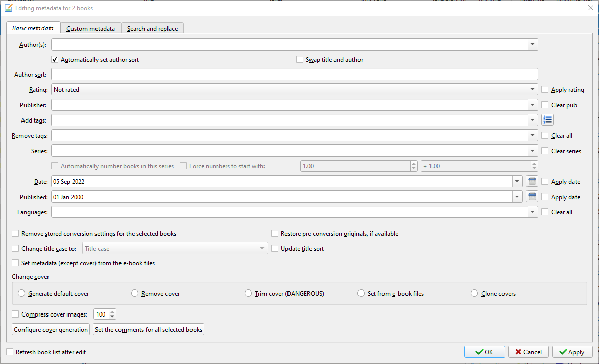

To correct the incorrect "author_sort" of the books, Selecte all books, launched a "Bulk editing metadata" and checked only "Automatically set author sort".
But that's just one step. All of this is mixed into several options and features scattered throughout Calibre.
To get the result you want, you will have to go very slowly, step by step.
Name:	Capture d’écran 2022-09-05 120525.png
ID:	196297   Click image for larger version

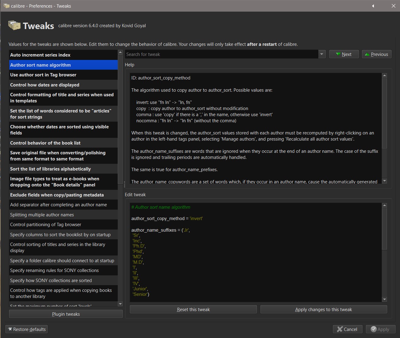

See this tweak:
Name:	Screenshot 2022-09-05 204746.jpg
And if you want different options on different libraries, there's a per library tweak in the JobSpy plugin:

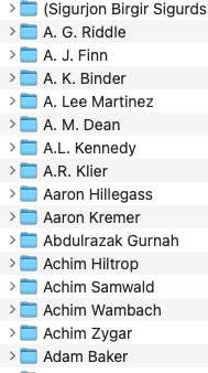

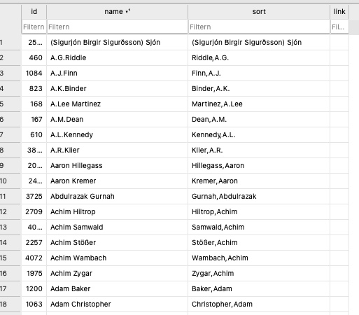

PS: Added 2 pics, one is harddisk, second is the metadata db, sort authors by name ascending.
Name:	Bildschirmfoto 2022-09-06 um 12.25.13.jpg
ID:	196314   Click image for larger version
Name:	Bildschirmfoto 2022-09-06 um 12.27.11.jpg
