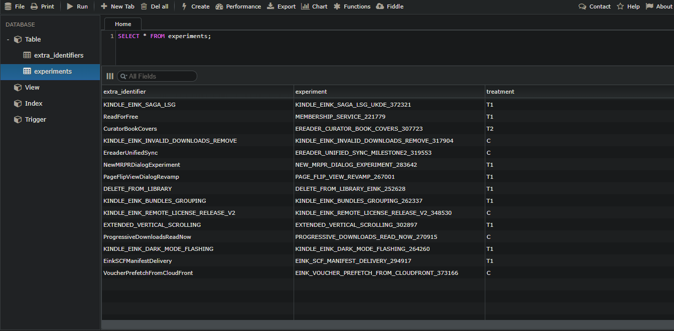

I decided to change the location of my amazon.com.br account to amazon.com in order to have access to the grouping of series (Group Series in Library) and Goodreads (in my country these resources are not available). Unfortunately doing so causes me to lose the Display Cover option again. So to fix this I have to replace the KWISClient file again with the one I had saved from the 5.14.2 firmware.
I also noticed that if I restart the kindle with wifi on, the Display Cover option simply disappears. For some very strange reason the kindle needs to be restarted with wifi off.
I compared the entries of the file KWISClient (with Display Cover) with KWISClient (without Display Cover). It seems that in this last one some values ​​besides the 'CuratorBookCovers' are missing. I wonder if this can somehow interfere with future features that the kindle can receive, since the KWISClient file I'm using belongs to firmware 5.14.2 and not the latest one.
Name:	KWISClient with Display Cover.png
ID:	195821   Click image for larger version
Name:	KWISClient without Display Cover.png

Hi dedeca
Is it possible to share your /var/local/KWISClient.db contents?
I would like to populate those two tables on my Oasis 3, because I have no backup of this file before I realized what happened.
Now I had only three records (extra_identifiers - 1, experiments -2). T^T
