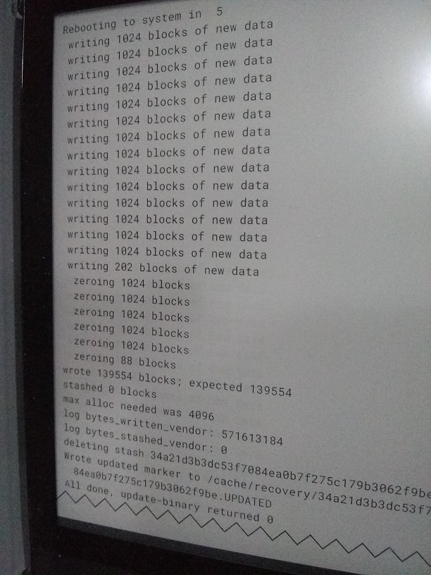

Well, that's one reason why I do stuff the way I do. I like to watch.
