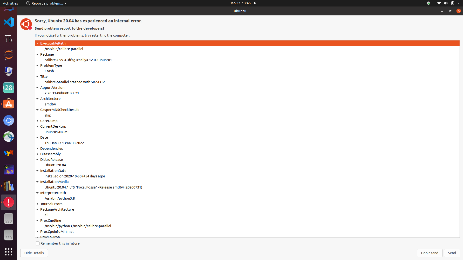

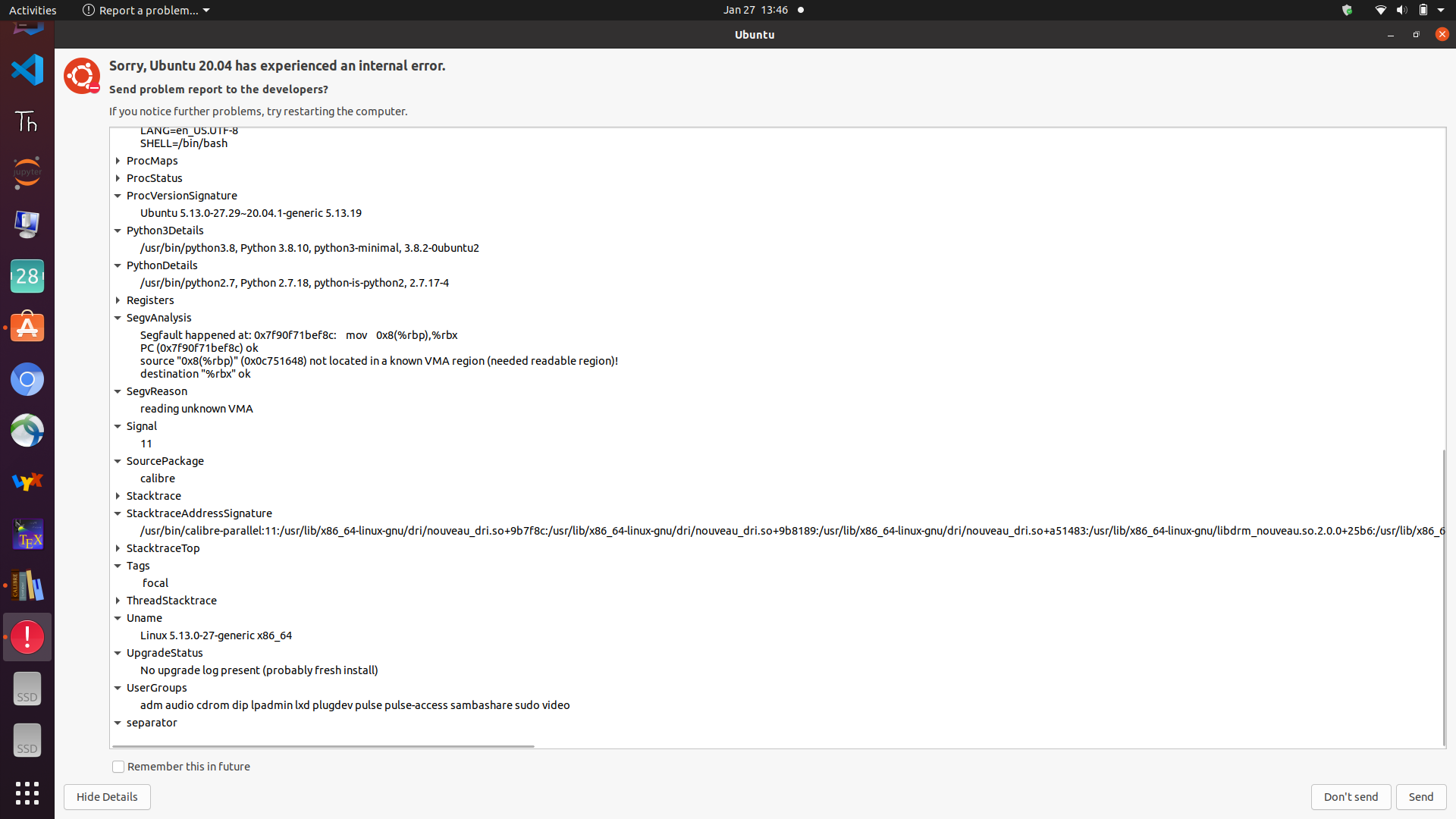

I installed Calibre E-book Viewer on Ubuntu Software but cannot find it in $ sudo apt list --installed I can only find:
calibre/focal-updates,focal-updates,now 4.99.4+dfsg+really4.12.0-1ubuntu1 all [installed]
I accidentally uninstalled Python3 not in my sandbox but the base of my Ubuntu ASUS ROG G752VL. When the computer repair shop rebuilt my Ubuntu all the apps work but not Calibre E-book Viewer anymore. The viewer sometimes works but crashes unexpectedly it is very flaky.
I tried "sudo apt-get remove --purge calibre" and reinstall but that didn't fix it.
Attached are images of my Ubuntu crash report. It clearly shows issues with the Python dependencies.

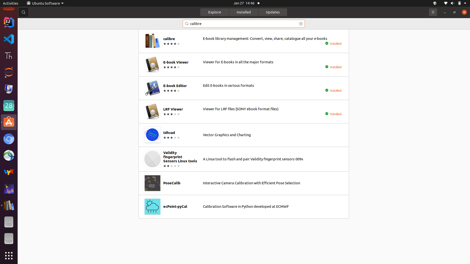

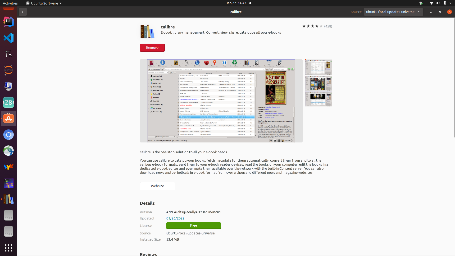

You mean?:
sudo -v && wget -nv -O- https://download.calibre-ebook.com/linux-installer.sh | sudo sh /dev/stdin
https://calibre-ebook.com/download_linux
I installed it from Ubuntu Software. See the attached images. Ubuntu Software is supposed to work.

That picture is a Beta version
5.99.4
5.35 is the released version
There is a thread under plugins (since PI have to keep up with the new Python) to report issues

Unfortunately, in calibre's case it often doesn't. That is why Kovid doesn't support Linux repository versions of calibre.
5.99.4
I see 4.99.4, which is even worse. That is a beta of calibre 5, more than 16 months old. Ubuntu should *not* be supplying that version.
Install calibre from the official download site: https://calibre-ebook.com/download
Most of the Linux repositories have a version of calibre available. Some have outdated versions (one I recently looked at is still offering 3.41), some have beta versions as in the beta for calibre 5 you are showing. Unless you have someone involved with the repository who actually cares about calibre (Arch Linux for one example), it is generally best to use the version from the calibre site.

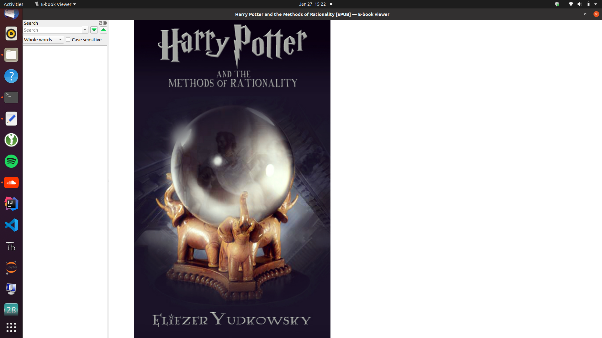

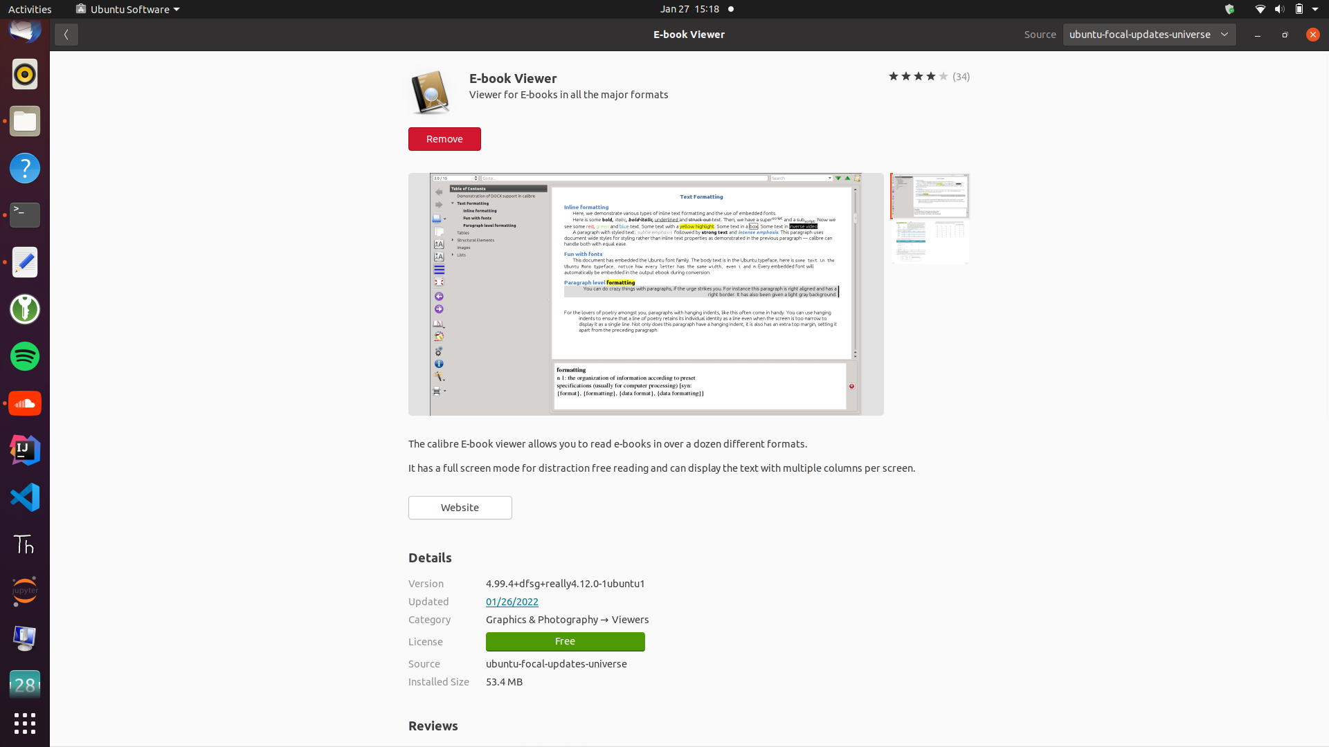

Thanks! I want to try to install calibre from the website. Does Calibre from the website include Calibre E-Book viewer?
See attached images.

Uninstall the beta 4.99.4 version you installed from the Ubuntu repository and install the official version using the command line from https://calibre-ebook.com/download_linux . If and only if, you still have the same issues, feel free to report them in these forums.
Yes, the viewer is part of the calibre package.
