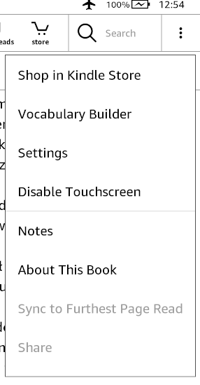

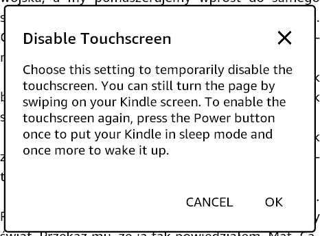

Disabling screen via menu triggers lipc daemon event com.lab126.kaf->startXBath.

    lipc-set-prop com.lab126.deviced enable_touch 0
end script
Now reboot and you should have disable-touchscreen option available and working

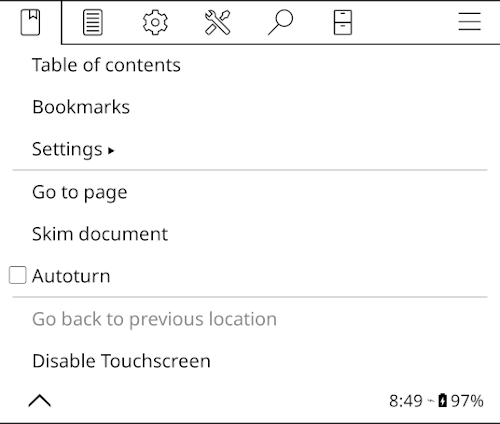

Originally Posted by lclrc View Post
BTW,is there any idea to use this feature in KOReader?
Let's see...
You need to extract the attached plugin to koreader/plugins folder

Originally Posted by MrTick View Post
Let's see...
WOW! Thank you! It works like a charm!
