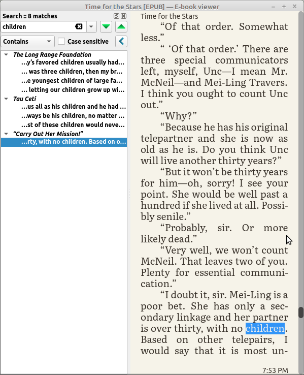

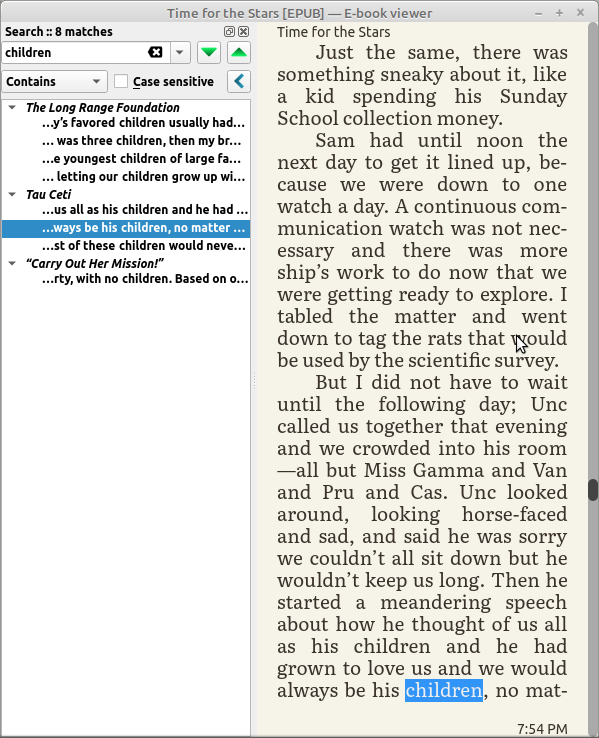

gbm
Posts: 2,215
Karma: 8888888
Originally Posted by oenwolf View Post
I'm running Mint 20. Installed 4.21.
When I search for a word and press enter, noting happens. If I press the arrow keys next to the search field, the results show up. Then I click on one of the results, and it takes me to the top of the chapter containing that instance of the word, but not the exact location of it. This is in flow mode. In paged mode, search works fine.
I ran calibre-debug --viewer. When I pressed enter after typing a word, the output was qt.xkb.compose: failed to create compose table. Then clicking on the result didn't print anything to console.
Search works for me.
My system
Linux Mint 20 Cinnamon
calibre 4.21
bernie
