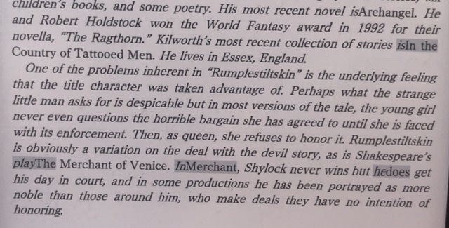

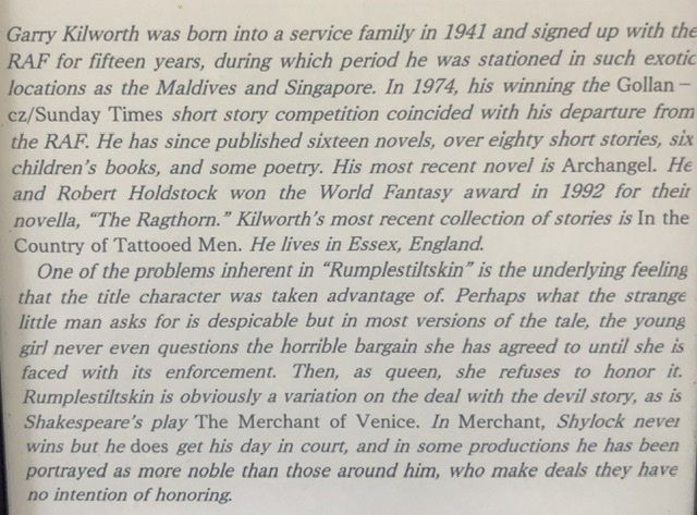

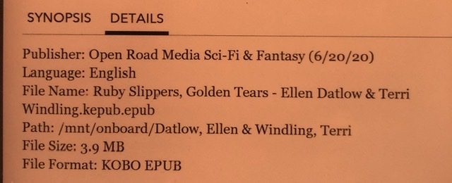

In the last 2-3 weeks I have converted ePub books bought from Kobo to ePub and then downloaded on my Kobo Aura 1, so I presume they were subsequently converted in kepub. I am attaching the details of the file.
There were some strange behaviour of the converter, I assume, where when some Italics text either preceded or followed a non-Italics, the words were joined.
See the attached pictures for as it was originally and converted (the picture with the highlights).
Could it be a new bug of the latest Calibre versions, or just some setting I did not correctly do ?
I have used version 4.18-4.19

Could you post a debug log from calibre or confirm you are using the most current version of all plugins?

What you have looks very much like an issue with the KoboTouchExtended driver. If you have not updated to 3.2.13 (it should have been an automatic notification), do so. You may also want to try converting to kepub using kepubify to see if the problem persists.

I am using now 4.20, with the plugin Kobo Utilities 2.11; just had updated it this morning, so for the previous conversion I must have had a previous version of the plugin, but right now I could not say which one.
I have checked, and the transfer happened at the beginning of may, so I must have had Calibre 4.14.
I have replicated the conversion with 4.20, the current Kobo utilities (ver. 2.11) and the move to my Kobo Aura 1; I checked a few previous problems and they do not appear any more; the resulting file seems to be ok.
