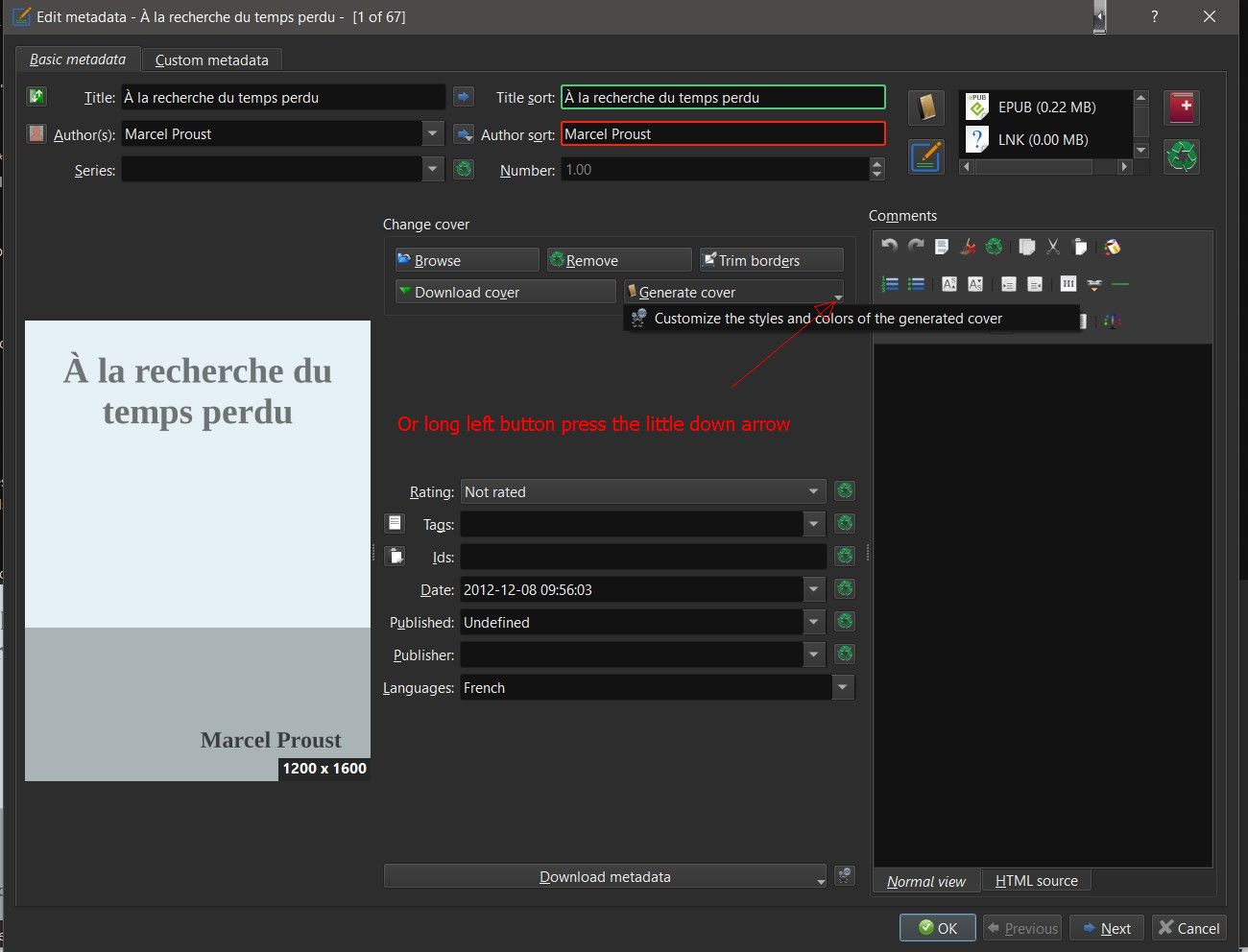

Nope, I am speaking of the built-in cover generator. To get to it, right click on your book and choose "edit metadata individually." There should be a button near the middle of the window labeled "generate cover." If you left click on it, Calibre will create a simple cover for you using some basic metadata and some random graphical presets.
To customize the cover generation, right-click on the "generate cover" button and click on the "customize" option that will pop up. There will be four tabs to choose from in this window, and the last tab, "text," will allow you to set templates for the title, subtitle, and footer.

Old 06-26-2020, 08:47 PM   #10
Posts: 22,435
Karma: 31000056
Name:	Annotation 2020-06-27 094251.jpg
