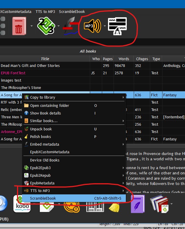

This is not a showstopper but I've just noticed a problem with non-display of the main plugin icon in some of my UI plugins. It may have been around longer but I've only just noticed it.
The problem seems to occur only in the right-click context menu and only for UI plugins which don't have a sub-menu. See attached screenshots.

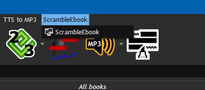

Using ScrambleEbook as an example of a UI plugin with no sub-menu, as you can see (2nd image) the plugin icon displays OK in the main toolbar and in the main menu. However in the right-click context menu (1st image) the icon is blank.
Compare this with the 'TTS to MP3' (which does have a sub-menu) next to ScrambleEbook where the icon displays OK everywhere.
I notice that the built-in tools/plugins which don't have a sub-menu (e.g. 'Polish book', 'Unpack book') don't have the same problem. I don't think the problem is specific to ScrambleEbook because 2 of my other (personal) plugins have the same problem.
This is the genesis code from ScrambleEbook in case this is where the problem lies.

Hmm. Maybe I spoke too soon.
popup_type = QToolButton.InstantPopup
gave me the icon in the context menu but it seems to have also disabled the Shortcut key setting which is working OK when I have
popup_type = QToolButton.MenuButtonPopup
... or perhaps I haven't found the magic combo yet. The genesis is as shown in post #1 and the bit before genesis() is
class ScrambleEbookUiAction(InterfaceAction):
    name = PLUGIN_NAME
    ttip = '%s\n(%s)' % (PLUGIN_DESCRIPTION, ','.join(OK_FORMATS))
    action_spec = (PLUGIN_NAME, None, ttip, _('Ctrl+Shift+S'))
    action_type = 'current'
    dont_add_to = frozenset([])
    dont_remove_from = frozenset([])
Is there an obvious error here?

Perhaps I didn't explain myself well enough. I have no problem adding to (or running from) the context menu. It's just that there is no icon displayed (on my Windows10 anyway) in the context menu when popup_type is set to MenuButtonPopup.
The context menu icon does appear if popup_type is InstantPopup, but then the shortcut doesn't work.
If I have to settle for only one of the two I'll have to choose shortcut over icon, but I'd like to have both working if possible.
