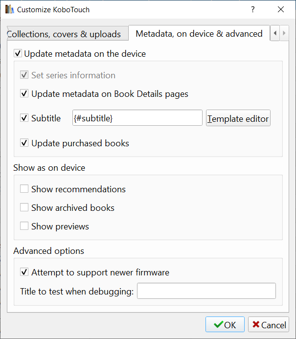

Can you post a couple of screenshots of what your calibre send to device and KoboTouch configuration settings are? I've included some screenshots of my setup to give you an idea of what I am looking for.

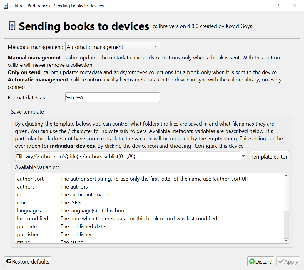

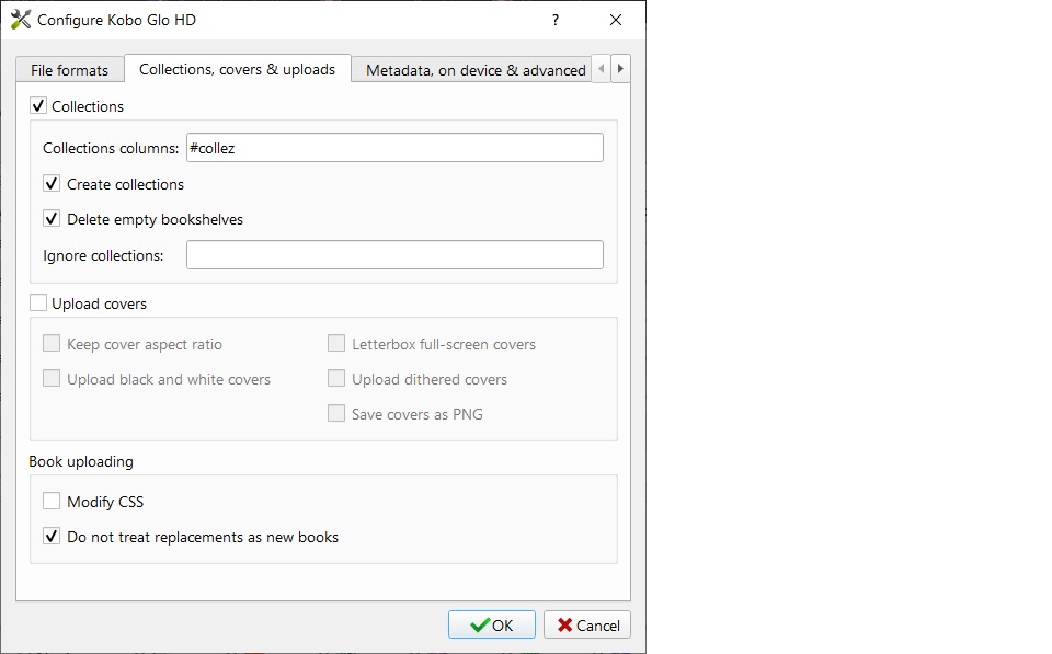

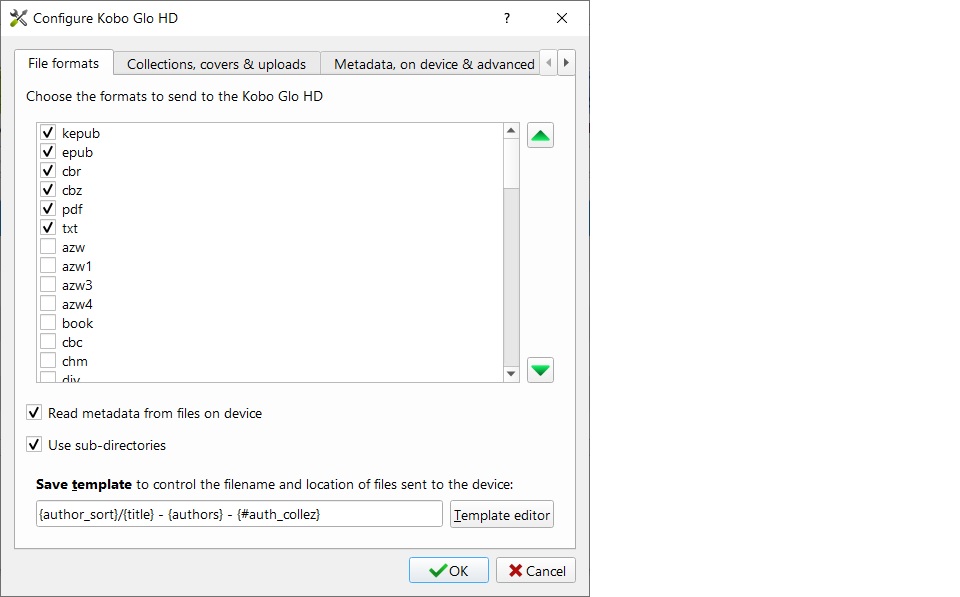

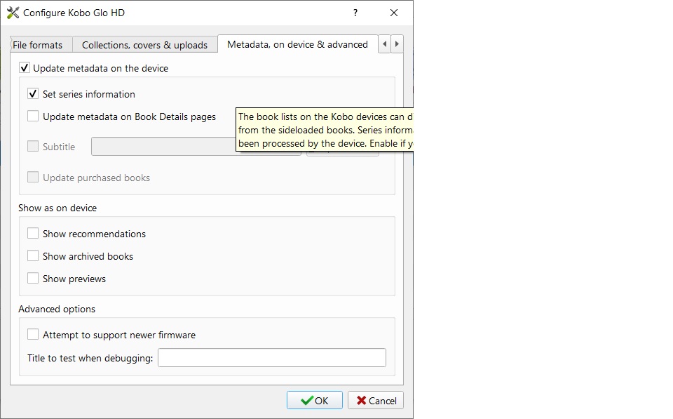

From the log files and the screenshots, almost everything looks good. You are using a custom column called "#auth_collez" for the collections. But, is there anything actually in that column for books on the device? The relevant part of the log is:
DEBUG: 148.0 KoboTouch:update_device_database_collections - set_debugging_title to ''
DEBUG: 148.0 KTCollectionsBookList:get_collections - start - collection_attributes= [u'#auth_collez']
DEBUG: 148.0 KTCollectionsBookList:get_collections - collection_attributes= [u'#auth_collez']
DEBUG: 148.0 KTCollectionsBookList:get_collections - end
DEBUG: 148.0 No Collections - reseting ReadStatus
DEBUG: 148.0 KoboTouch:update_device_database_collections - managing bookshelves and series.
Before the last line in the log snippet, there should two lines for each collection that is being added or changed on the device with the number of books in the collection. The fact there are none says that none of the books on the device that match with books in calibre have a value in the column "#auth_collez". The other reason would be that the column doesn't exist.
Does the column have any values?

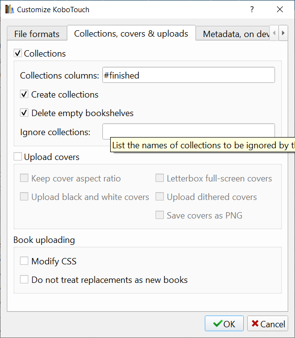

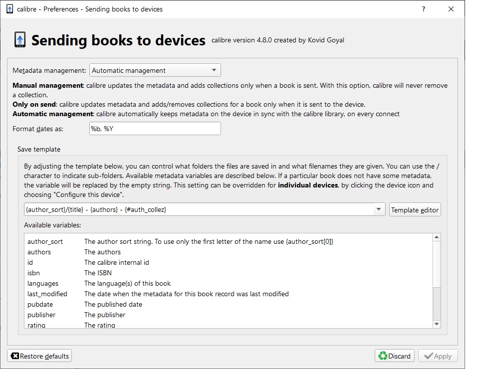

I finally found a solution out of desperation yesterday night.
The problem was the custom column, but not how you're thinking. I always had this column built with author+series working for creating collections on my kobo. The field is full of contents, I assure you. The problem was another. I always used the name "#auth_collez" to create collections but it was just the column name, its lookup name was simply collez. Yesterday night, really out of desperation, while I was trying to create a new column from scratch, I noticed the discrepance between colum_name and lookup and I tried and used just the lookup name #collez. And it worked!!!!
I don't know why the column_name always worked before. I don't know if the problem is the new firmware on my kobo or the new calibre version or a combination of both!
I'm just happy!
I'm detailing this for further reference. I'm also putting screenshots.
Thanks to everyone
