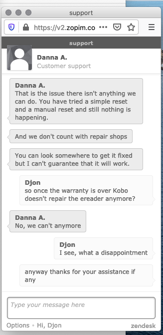

Name:	Screen Shot 2019-12-26 at 4.08.02 PM.png
aikidoka is offline   Reply With Quote
