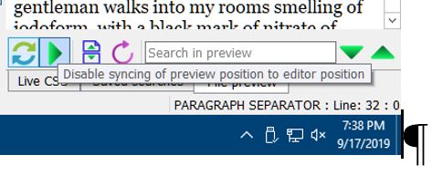

Did you accidentally click the Green Triangle that points to the right?

@ phossler
It is not green nor a triangle in my version of Calibre, but I never noticed that dangerous little widget! Easy to click in its position like that. Do you know why anyone would turn off syncing of preview with editor?
Visually, the relative lack of distinction between the on/off positions could also contribute to not even realizing an accidental click happened. It is a button with maybe an up/down position, but no label, like with a checkbox...
Because you are trying to work out why a bit of code works but the exact same thing elsewhere doesn't. Or because you are updating text somewhere and want to see what is written elsewhere to make sure you get it right. I don't turn it off very often, but I have done it for both of these reasons.

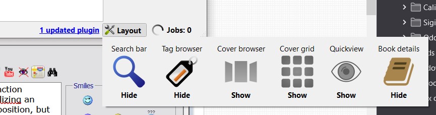

I'd prefer a "Toolbox" button similar to the Layout button in the main window status line. I don't use the Preview window buttons often enough to remember what they do, and I also have problems with hovering the mouse. In case anyone's forgotten, I'm talking about this:

There's a check box in Look & Feel to show individual buttons.
