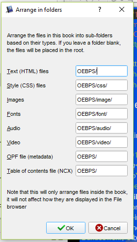

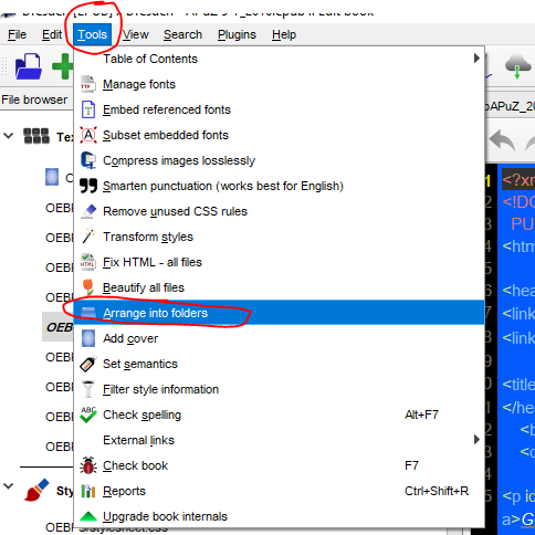

in addition, there is a tool called Arrange into folder that can help you.
ID:	165350   Click image for larger version

I can see what I wrote was unclear sorry. the order of events is (1) use the tool ‚arrange into folders‘ (2) at some subsequent point, create a new html file. Now, the editor ,knows‘ I have arranged the files into folders (if you try to use the tool a subsequent time, it will say files are already in folders), so maybe it should be clear to the editor that I have expressed a preference for where new text files should be created.
