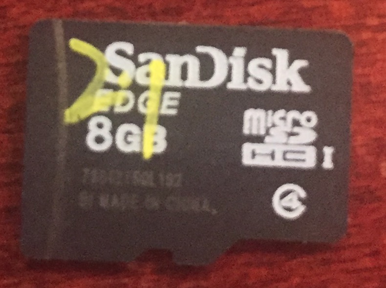

2) The built in SD card is a Sandisk Edge 8GB.

I don't have crystaldiskMark, since I'm on a Mac, but I have a similar program. Here is the speed test results for the Clara.

It isn't that great.
I replaced it with a 32GB Samsung Evo Plus card, that has faster speed tests.

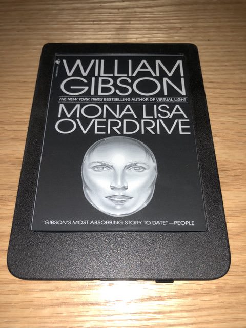

plastidip
just did the plastidip mod, decided to do both the back and the front.. loving how grippy it is now, thanks again for the tip!
I already had the nobiggi strap applied before I did the plastidip so I had to mask that off with painter's tape beforehand. ended up doing 4 coats total, figured that was enough but considered getting some clear plastidip or even the glossifier to go on top as well.
