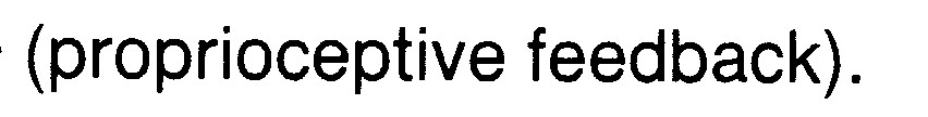

I scan at1 TIF 600dpi at greyscale in my scanner OpticBook 3600
as you can see in this screenshot, the scanner somehow produces images with some marks, I don't know if glossy paper is responsible for this (the marks look like reflections) or the scanner or something else
this is the crop of a scanned page:
this is the same crop but with lowered brightness and contrast in photoshop:
the characters have marks around them and these can cause problems to the Finereader 9 and spot them as 'uncertain characters'
do you know what causes this?

You can convert it to a two-level (black and white, no grey) image, or touch the "levels" so that everything above some threshold is pure white and everything below some other threshold is pure black.

This is just the scanner showing you what's there -- the paper around the letters probably is a little darker. Adjust the scanner settings to increase the contrast. Come to that, if you're scanning at 600dpi, you can probably get better results scanning in black and white, not greyscale (except for images, of course). 1-bit sample attached.

One thing you can try is to go to the filters and then noise and try despeckle or dust & scratches.
