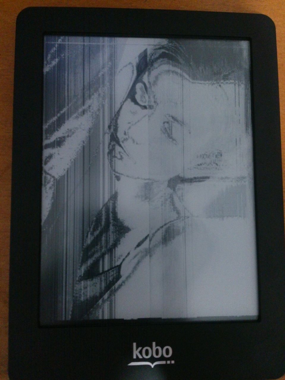

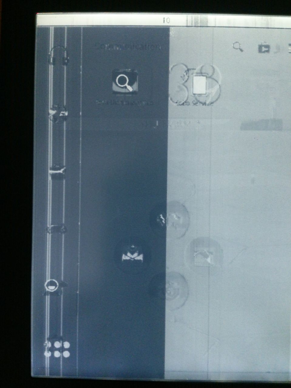

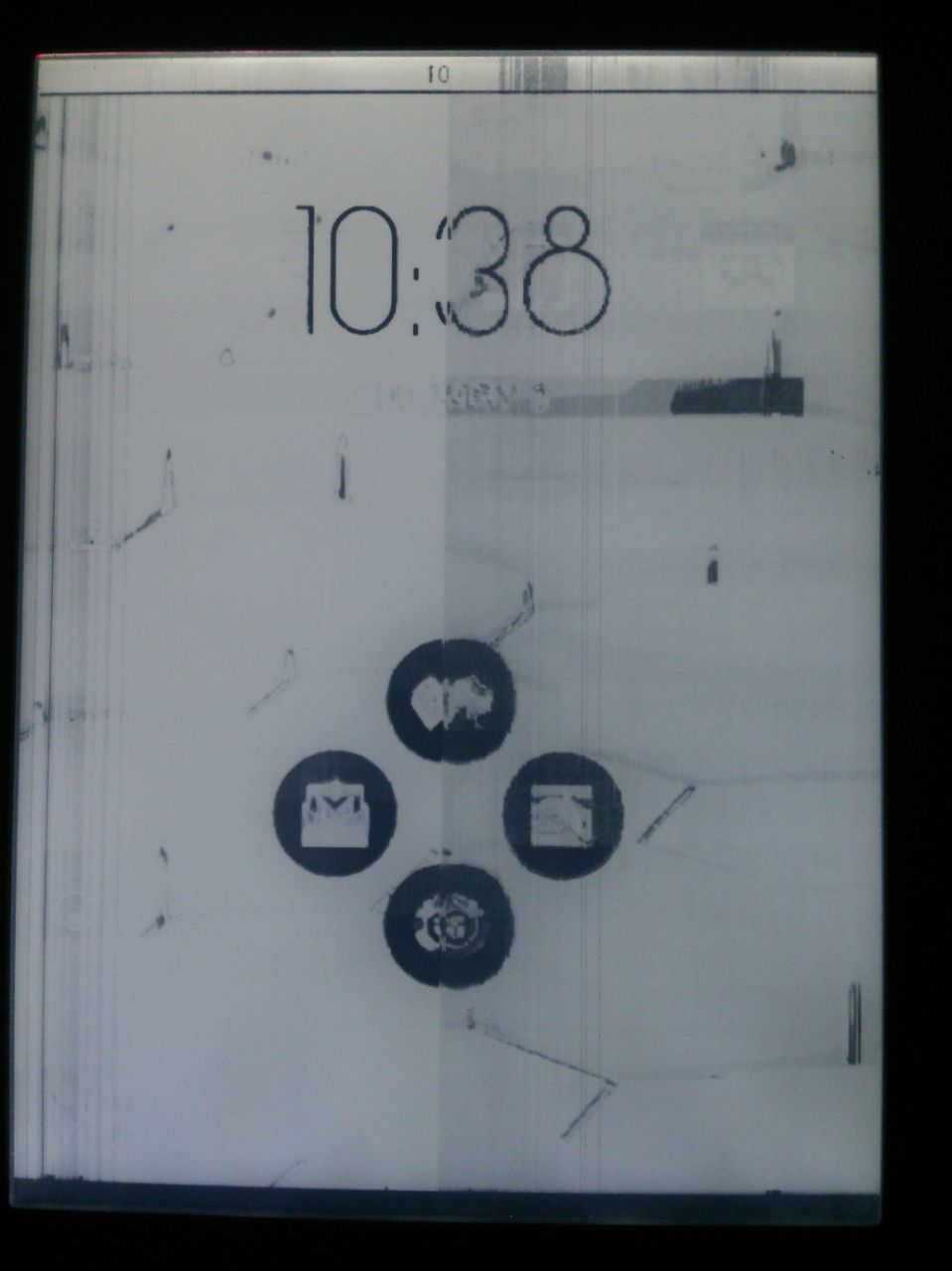

screen of my kobo glo is damaged after airport x-ray scanners does not display correctly
what can i do for my kobo
please help me

I read somewhere the problem is caused by static and the damage is permanent.

“I don’t think the radiation used in an airport scanner would ever be strong enough to damage an electronic ink display,” said Professor Daping Chu, Chairman of the University of Cambridge centre for Advanced Photonics.
"But you can get a build up of static inside these machines, caused by the rubber belt rubbing. If that charge were to pass through a Kindle, it’s conceivable that it could damage the screen.”
Electronic ink screens use thousands of tiny capsules filled with magnetic black and white particles to display text and pictures.
It is controlled by applying a small voltage across the capsules, which sends either the positively charge white particles or the negatively charged black particles to the front. They stay in place until the next time a voltage is applied, which allows the Kindle battery to last for much longer than in gadgets that use LCD screens, such as the iPad.
“A static charge from an airport scanner could be 100 volts or more,” said Professor Chu. “That could permanently stick the particles to the screen.”
