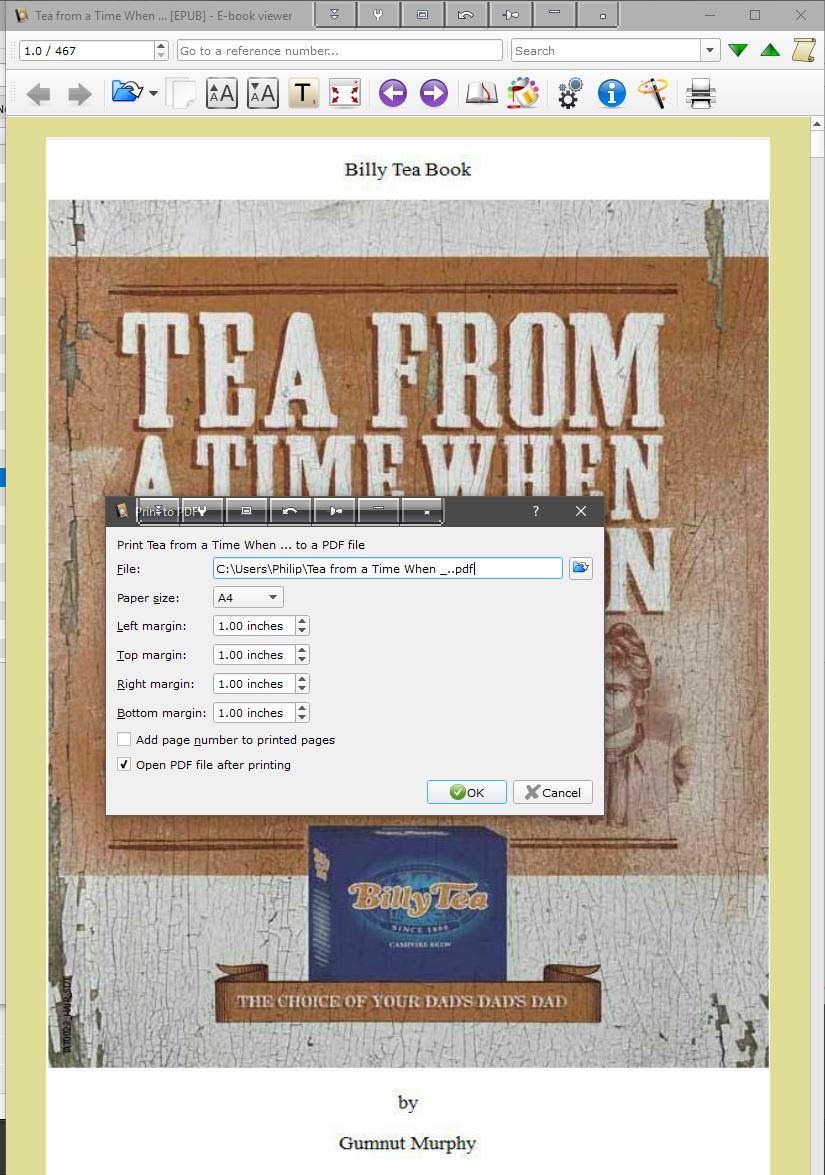

When you print from the calibre ebook viewer you get this dialogue
Attachment 154837
Thanks Red. Everything got straightened out when in LibreOffice I set the paragraph indents. (The line spacing and everything looks right now.)
