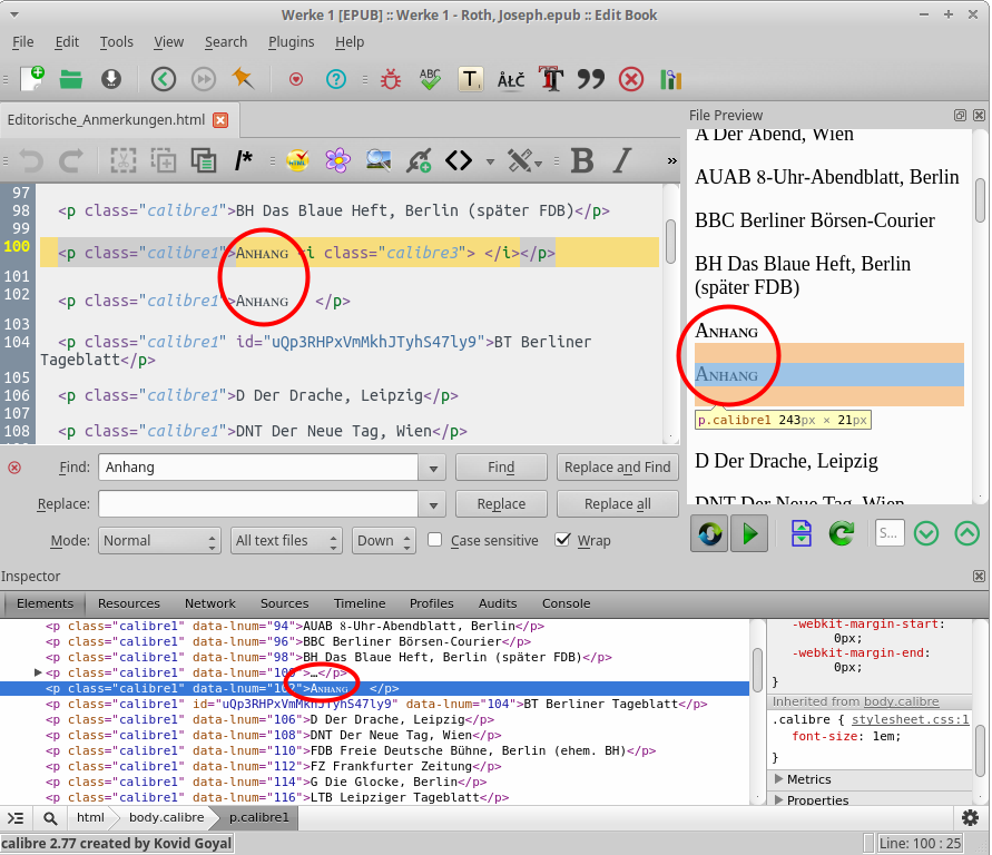

I convert a .pdf to .epub. But some words are still formatted, e.g. ''Anhang''.
I can not search for the word by writing ''Anhang'' in the Search(Find)-Box.
Name:	''Anhang'' formatted.png
C&P the formatted ''Anhang'' I can search for it.
Both cases allow to remove with S&R, but the formatted version only in whole code-expression:
<p class="calibre1">Anhang <i class="calibre3"> </i></p>
or
<p class="calibre1">A </p>
Isn't that strange!?

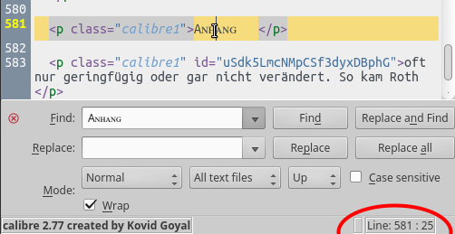

It looks to me from your first image that the "nhang" characters in that word may actually be unicode small cap glyphs. Move the cursor there and check the bottom right status line in the editor.

Yes, it looks like small cap glyphs, and what you may not be able to recognize clearly: the characters are somewhat blurred/indistinct.
Name:	no name letter.png
''no name letter''

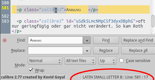

Name:	LATIN SMALL LETTER B.png
LATIN SMALL LETTER B (Just to make the difference recognizable, a ''normal'' character.

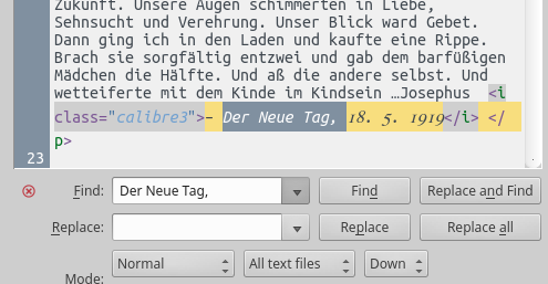

Another remarkable thing: I can search for Der Neue Tag, (incl. comma & empty space) and find, but not for the date . .  (!!! even here it keeps the formatting (or whatever that is !!!). The date is only to handle per C&P.
Name:	Der neue Tag, .png
Der neue Tag, incl. comma & empty space
In practical handling that creates some problems!
