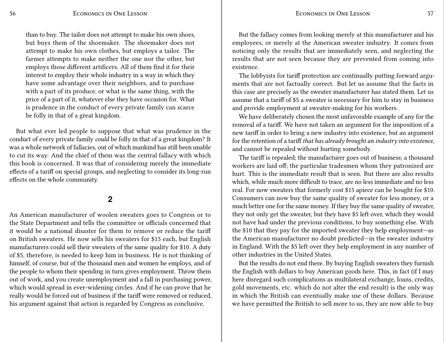

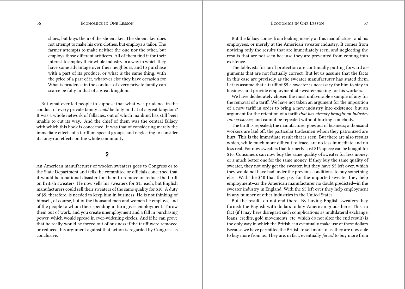

If you are creating a "Mobile-Friendly" version of the PDF, me + RbnJrg figured out that a paper size of 5.5"x8.5" with small margins + 12pt font is still very readable on very small devices (smartphone) to very large (PC monitor). The amount of text you can shove per page can be roughly equivalent to your typical 7"x10" book.
Here is a comparison between a 5.5"x8.5" (tiny margins, "Mobile-Friendly") + 6"x9" + 7"x10":
ID:	153488 Click image for larger version
ID:	153489 Click image for larger version
Or here is a comparison of a two-page spread of the 5.5"x8.5" + 7"x10":
ID:	153491 Click image for larger version
Of course you can tweak any of the variables... but I still think it would be an inferior experience compared to a proper EPUB.
