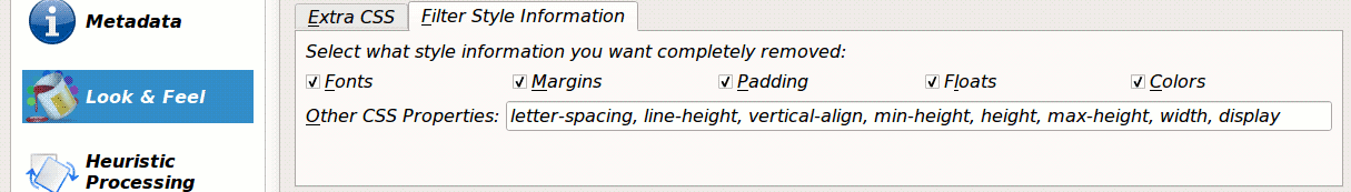

I use Calibre's style filtering to get rid of most offending styles.

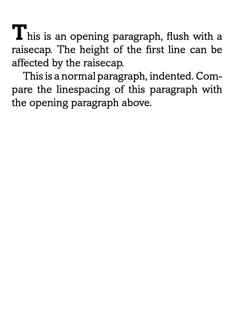

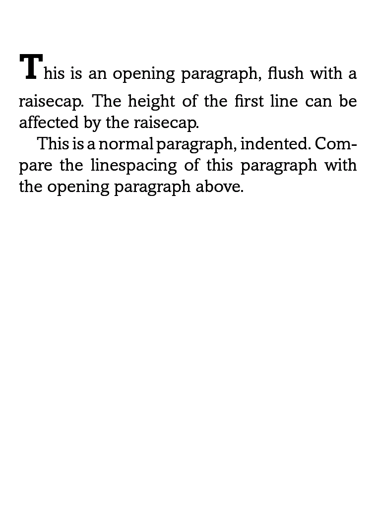

Here is an example of a problem that can occur if you simply strip all line-height styles, instead of just the ones used for the main text:
On the left is an epub with a raisecap, the raisecap span has its line-height set to zero to prevent it affecting the line spacing of the rest of the paragraph. On the right is what happens when that line-height style is removed:
