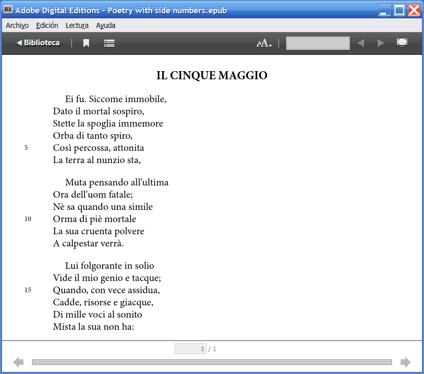

And what about something like this (that also works in any ereader):
The above screenshot belongs to ADE 3.0 and to get that result, you only need a few lines of code:

and in the .xhtml file:
  <h3>IL CINQUE MAGGIO</h3>
  <div class="stanza">
    <p>Ei fu. Siccome immobile,</p>
    <p>Dato il mortal sospiro,</p>
    <p>Stette la spoglia immemore</p>
    <p>Orba di tanto spiro,</p>
    <p class="number">5</p>
    <p>Così percossa, attonita</p>
    <p>La terra al nunzio sta,</p>
  </div>
    <p>Muta pensando all’ultima</p>
    <p>Ora dell’uom fatale;</p>
    <p>Nè sa quando una simile</p>
    <p class="number">10</p>
    <p>Orma di piè mortale</p>
    <p>La sua cruenta polvere</p>
    <p>A calpestar verrà.</p>
  </div>
    <p>Lui folgorante in solio</p>
    <p>Vide il mio genio e tacque;</p>
    <p class="number">15</p>
    <p>Quando, con vece assidua,</p>
    <p>Cadde, risorse e giacque,</p>
    <p>Di mille voci al sonito</p>
    <p>Mista la sua non ha:</p>
  </div>
So, you only need to add <p class="number">"your number here"</p> in the proper place; everything else is the same you have done always.
Below you can check the respective epub.
That means that the ereaders based on RMSDK could show automatic numbering Below you can check the respective epub3 ebook and thank you very much Doitsy for being the first in thinking to use counters for this task.
