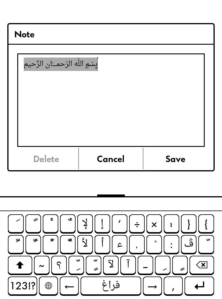

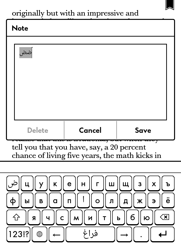

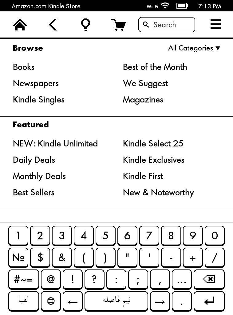

I have started working on an Arabic Keyboard for my "kindle Paperwhite 1"
This work is unfinished yet and is based in the Russian keyboard When I finish it I will put the files .here is the screenshot.

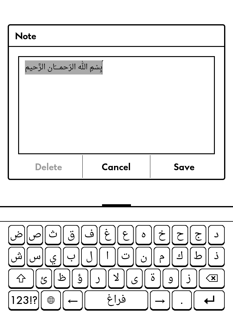

Here is the final work .
In order to install you have to do these following steps :
1. Install Russian Language keyboard " Update_kbd_ru_1.0_k5x_install.bin"
2.Select Russian Keyboard.
3. Pusth the file "it" into this location : /var/local/keyboard . Or its contents into "it" file and replace the existing file .
4.Restart Kindle Paperwhite 1.
5.Enjoy Arabic Keyboard
6.شكرا لكم
7.If there is any problem Just tell me .
Ps: Files are in the attachments . I used WinSCP to put files in my kindle pw1.

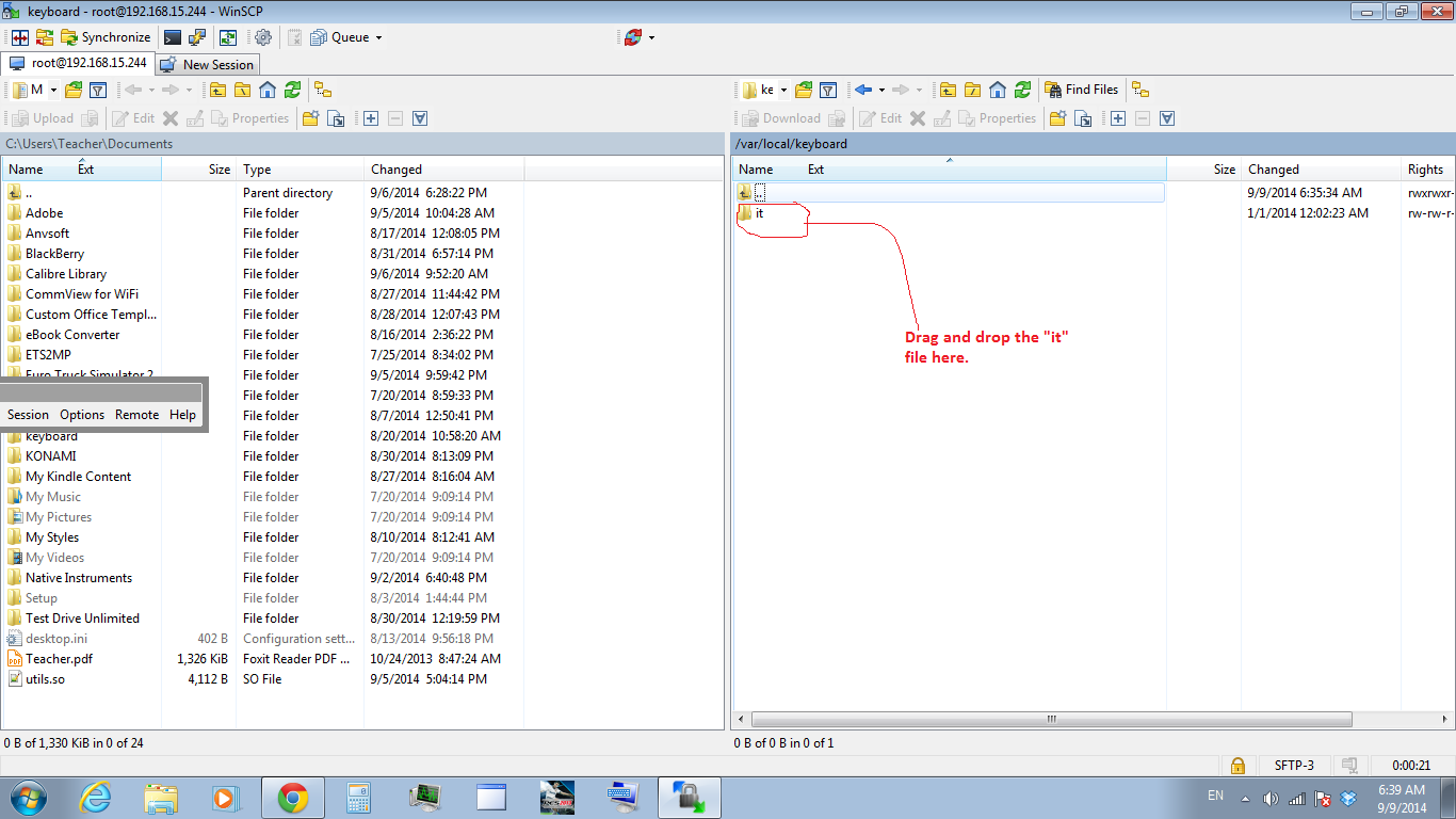

Hi
Thanks for your job,
I installed the ru keyboard but I cannot find the location to place the it file

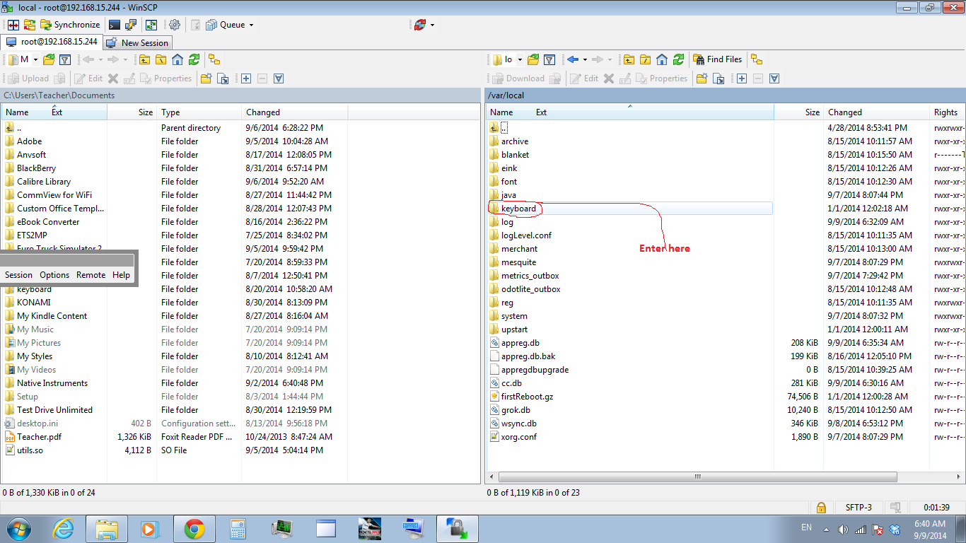

Originally Posted by eshahinfar View Post
Hi
Thanks , Here is what to do :
I have put the steps in the screen shots.

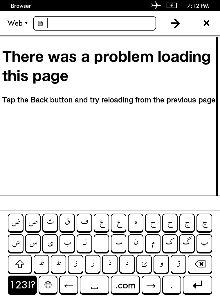

According to your job I have modified Arabic keyboard and created Persian keyboard for kindle and tested it on kindle PW1. I attached the it.rar file and some screenshots for Persian Keyboard.

Aboyaman
Diacritical symbols (long tap) remained cyrillic.
eshahinfar
Seems, locale code for persian language - it's fa_IR (farsi-Iran).

Originally Posted by Aboyaman View Post
we are typing with short tap not long tap since all the Arabic characters are there in the keyboard
Then unnecessary diacritical symbols of cyrillics can be removed.
What for superfluous symbols on keyboard?..

Since you are the developer of the Ru keyboard why dont you help us building "Arabic keyboard update.bin" for example? , because I couldnt make one .
Thanks in advance.

No problems: sources + bin.
But i did not test it...

I tested it . Works great in PW1. Thank you so much , May God bless you .
