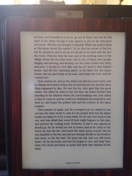

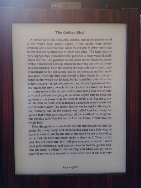

I've been looking at the pictures in this post
Those are all KEPUBs, with the header on top and the footer? Does reading time per chapter and per book work with your side-loaded KEPUBs?
The first and last picture are ridiculous. Talk about screen waste. Bleh. That's a useless book display IMHO.
The second and third look okayish, but they only display 24 lines of text. The Kindle Paperwhite when using Palatino size 3 or 4 (depending on the book) displays 26 to 28 lines of text, on a 6 inch screen.
Do you have any more pictures of the Aura, or are you inclined to take the ones I mentioned in the first post?
At this point in time I have this image of the Aura HD:
1. Book stats (reading time per chapter/book) doesn't work on side-loaded EPUB nor KEPUB.
2. Uploading the page number calculated by Count Pages is not possible.
3. The Aura HD displays less lines per screen, but some more text per line compared to the Kindle PW2; there may not be more text on screen as compared to the Kindle.
Is this correct?
I could live with omitting nr. 1 and 2, but 3. would be a huge dealbreaker. In that case, upgrading to the Aura because of the larger screen is of no use (to me).

Here are the pics you requested - note, the supplied kepub didn't want to work, so I generated one from the epub via calibe. (epub then kepub):
ID:	119529   Click image for larger version
ID:	119530   Click image for larger version
ID:	119531   Click image for larger version
jandrew is offline   Reply With Quote
