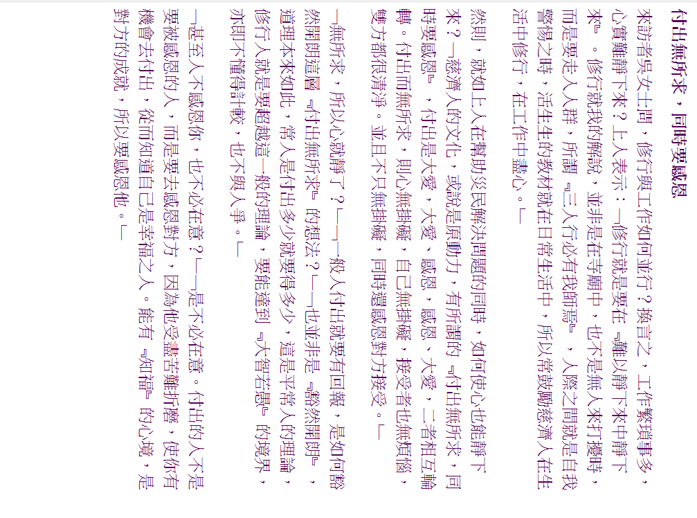

The original ebook is chinese characters in vertical direction. When i imported i open the epub in Calibre it becomes rotated ....please see link for image...
What i have done is to tweak the book (explode, change style sheet and rebuild book) by changing the epub writing mode from vertical to horizontal as shown below.

This actually works...but i can only do this one book at a time...to tweak a new book every time.
Instead of having to tweak every time, I would like to have the ebook open correctly every time. I tried applying the same stylesheet shown above inside the e-book viewer user stylesheet, but unfortunately it doesnt have any effect...the other books still open incorrectly...i have to tweak one by one which is too tedious as i have more than 100 of such books...
