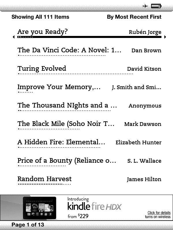

I couldn't reproduce your issue; I can see a final question mark in titles with my Kindle. Check the .ePub and .mobi below.

When I drag and drop your example .mobi file onto the "Send to Kindle" app (on a Mac if that makes a difference) the "Title:" shows "Are you Ready_". Even if I change the underscore back to a question mark before I hit send, the underscore still shows up on my Kindle Fire and in the Kindle app for iPad. Did you use "Send to Kindle" to load it onto your device? If so, Windows or Mac?

Sounds like a bug in the "Send to Kindle" program. Clearly Kindlebooks can be created with question marks in the title (and can be displayed by the Kindle devices/apps with question marks in the title), so that only leaves one culprit.

No, I uploaded the file with the USB connection. So, I think that DiapDealer was right, it must be a bug in the "Send to Kindle" program.

Well, "send to Kindle" simply uses the PDS (Personal Document Service), which "converts" the file, as if you uploaded it at the KDP. Have you tried uploading the mobi file at KDP, to see what results you get in the Preview? I know we've made books with question marks in the title, and I don't recall any issues.
