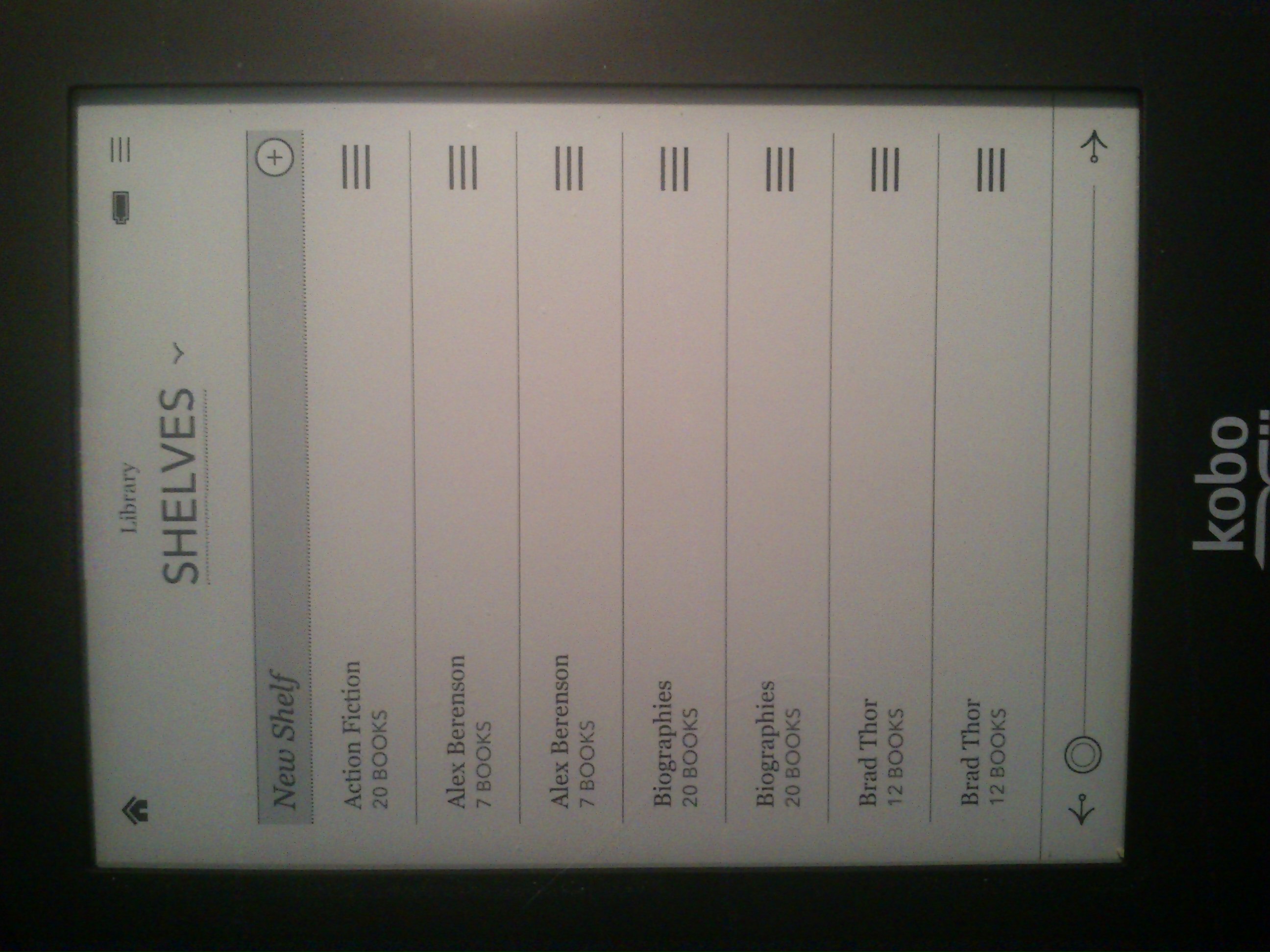

I have a Glo running the newest 2.6.1 from 06/17. I sync'd the glo today with Kobo desktop. Prior to this I had the original 2.6.1 from 06/06. After the sync I ended up with double shelves. Not all the shelves, but most were showing up twice. Deleting one does nothing. I tried a reset, a hard reset and a factory reset. Once I reload books from Calibre, two shelves show up. This only started today after I downloaded the newest version of Calibre. Pic is included below. Any ideas? Anyone else seeing this? Deleting a shelf does nothing. It's still there.
I should mention I am using no plugins on calibre but am using the plug board for series sort.

After a number of resets, signing out of my account, syncing with the desktop app, I can always get to this point;
All the books are gone (I side load all my books through Calibre) and I have no shelves on the device.
I did lie earlier, I forgot that I do use the standard kobo plugin to create shelves. My apologies for the misinformation.
So anyway here is where I am, an empty device with no books and no shelves. When I reload my library with Calibre, double shelves again. But not all of them. In the pic I attached you can see the first shelf isn't doubled.

So I deleted the library confirmed there were no books or empty shelves. Then I turned off the "create shelves" in the kobo plugin. Reloaded all the books. Everything fine, no shelves. Unplugged device. Re selected "create shelves" in the kobo driver. Attached my Glo, the metadata was sent to the device. I unplugged and there they were again, double shelves for 23 of the 31 I use.

One more interesting find..
I cannot delete or rename the doubled shelves but I can delete or rename the single ones.

Originally Posted by taming View Post
I am still not seeing the step where you delete the shelves on the device then sync with the Kobo server, confirming that after the sync there are no shelves on the server itself. This post was sent as the OP posted the one before.
I have never downloaded books from kobo to my Glo. I always side load them. Having said that I did delete everything, including shelves from the Glo and then did a sync with kobo desktop. Then unplugged and checked the device. There were no shelves or books. The shelves only show up (and doubled at that) when I use calibre to send my library to my Glo. And as I said, this only started today after I downloaded the new version of Calibre. Might be a coincidence though as I went back a version and it didn't fix the problem.

I've got it. On three devices...my Mini, Glo and Aura. And my Glo is still on 2.5.2 so it wasn't caused by 2.6.1
I use Calibre to side load books but nothing to do with my shelves...all of them were created on the devices themselves. If I have a calibre plugin that creates shelves on the Kobo i've never used it and didn't knowingly install it.
As someone else stated I can't delete the duplicate shelves. If you add books to a shelf with duplicates you don't get a save button, you get a create button. And then voila! You have ANOTHER duplicate shelf. All with the same books plus the new ones you just added. It's weird and annoying. I can delete shelves without duplicates.
Syncing on the desktop got rid of one set of duplicates on the Mini, but one set of duplicates remained. Synced again, same thing, that one set just won't go away. Haven't synced the Glo, I've been keeping the wireless off because I like the way the light works in 2.5.2 and I want it to stay that way. It seems like a step backward to me.
