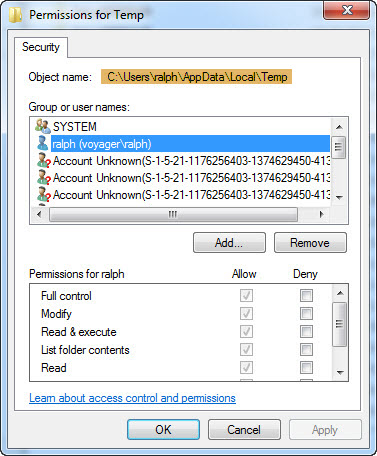

Based on the Permissions window I see, I do have "Full Control" on the "Temp" folder.
I captured an image of the Permissions window but can't figure out how to attach this image.......if I were to post it to Google+ how do I allow you sole access??

The attached file will show you why I said I had "Full Control" of the Temp folder.........am I misinterpreting what I see?

Posts: 81,055
Karma: 150250983
What does it show under SYSTEM? Also, I have another entry called Everyone that also gives full permission. Also, if your account is an administrator account, try setting up an Administrators entry to give full permission.
Another thing to do is remove all those Account Unknown entries and any other accounts not being used there.
Yes, it does look like it might be correct. But give it a go like I have things and see how it works.

@ralphjab, I just spotted you screen post
Those unknown accounts have identifiers that are normally found within a corporate environment. Is your computer on a corporate network, if not what's the provenance of the Windows license. If you're on a corporate network get your IT security guys to 'fix' it.
If everything is kosher then - I have a vague recollection of reading something that suggested rootkit viruses mess with user accounts in this way. Rootkit viruses are said to be hard to get rid of - I've never seen one so I don't know if that's true. I suggest you make some enquiries at Wilders Security Forums or the Windows (XP/Vista/7/8) forum.
You could try removing those unknown accounts, before doing as I suggested in my previous entry - if they come back then that could add evidence to the rootkit infection theory.
Also - the screen shot you posted is an abridged view of the Windows Security Settings.
That's MS's paltry effort to hide the complexities about which I just just ranted.
IMO it's better to try to wrap your head around the full story in the Advanced section.
There's a comprehensive CHM file behind the blue links you see on the various dialogues, its hard going but... its better than anything else of which I'm aware.
