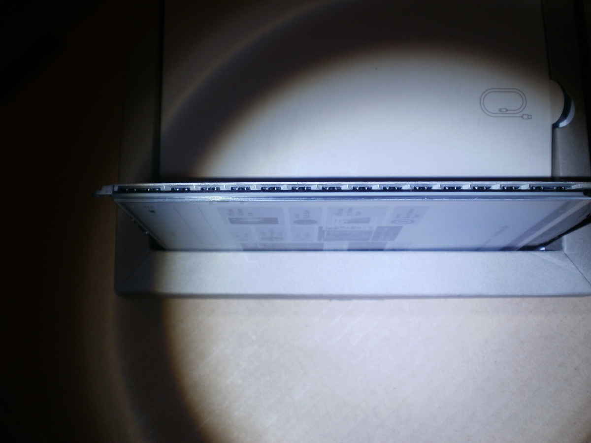

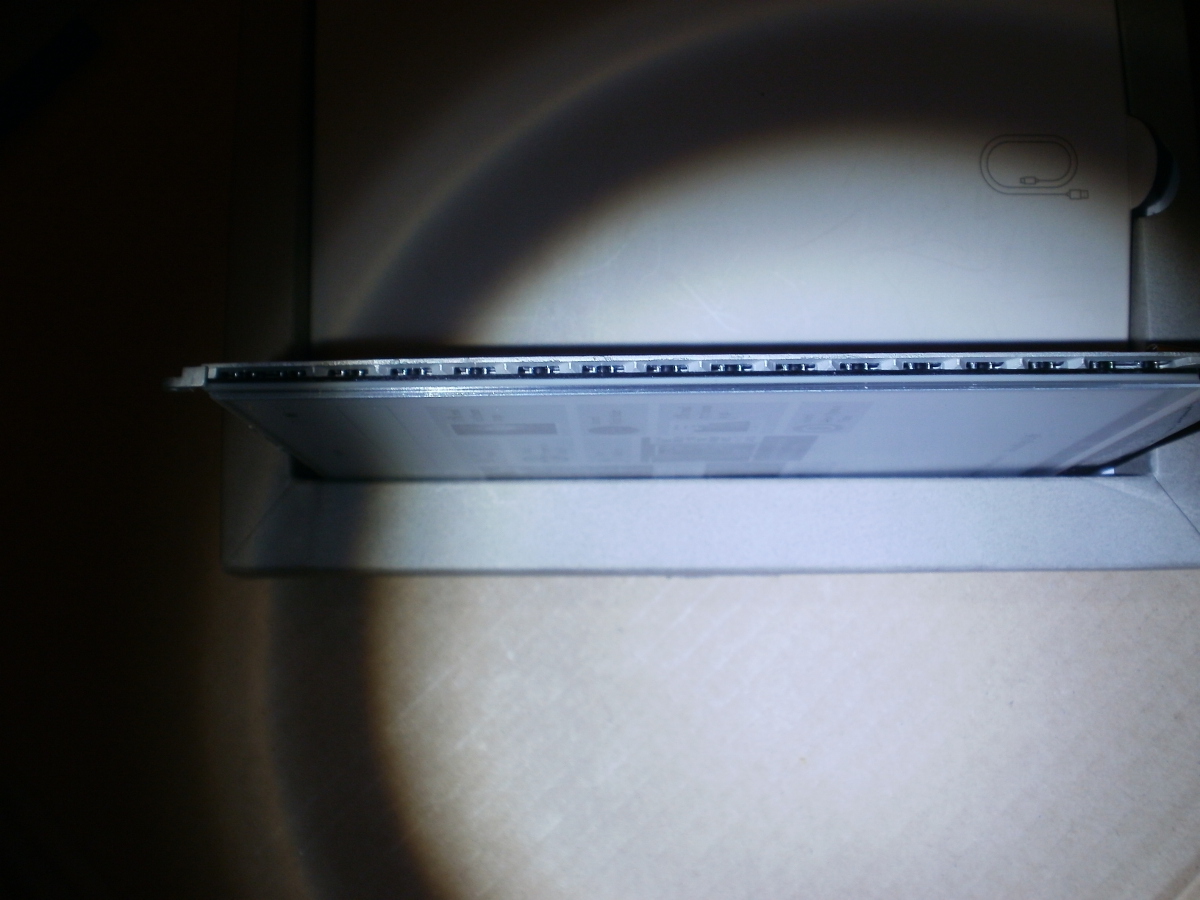

Don't see how anything could be above the screen, the top piece of plastic anyway,
and allow a path for IR light (which still must travel in a straight line, I would presume)
that anything could interrupt. I was thinking that when you press with your finger it
deflects the top layer and that is what interrupts the IR beams, silly me.
Some pictures of the edge of the AuraHD are attached, if you look at them full size you
should see how there are little ICs spaced all around the edges, I guess they would be
the IR emitters.
Name:	AuraHD edge1 004T.JPG
ID:	105862   Click image for larger version
Name:	AuraHD edge1 005T.JPG

@ Ken, IR light travel via black plastic layer between the screen and top case.
I have painted my Glo, after that the touch didn't response at all because the black plastic coated with paint. So I try to remove the paint with paint wax and the touch become response again.

When I look at my Aura, between the bezel and the screen, there is a narrow space which is set a millimeter or so back from the edge of the bezel. I had assumed that the plastic on the back of the gap was an IR filter which covers the emitters on one side and the receivers on the other side of the Aura (ditto for top and bottom of the screen). I have noticed that if anything gets into there (cat hairs, for instance), the touch screen can behave very strangely.
Regards,
David
