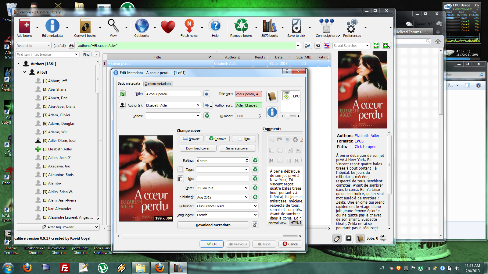

I have some problems understanding how sorting of authors work...
See the picture in attachment.
This example shows an author "Elizabeth Adler" in the letter A, and the metadata looks fine. But i'd like to see it sorted like in the author sort field that i see in the metadata.
Why isn't it working ? How to correct this, what am i missing ?
Thanks for your support

Old 02-04-2013, 12:11 PM   #2
Posts: 31,578
Karma: 62544528
your metadata is inconsistent (on the Left)
some of those are LN. FN
This one is Fn Ln and is sorted in the correct place for that.
BTW Note the RED Title sort. you may have the books Language set incorrect (sort rule to use) or it is just wrong
The Quality Check Plugin can help sort and fix the inconsistent part.
Preferences: Tweaks: has various sorting overrides ( take time to review all the tweaks,then form a plan to go with your choice)

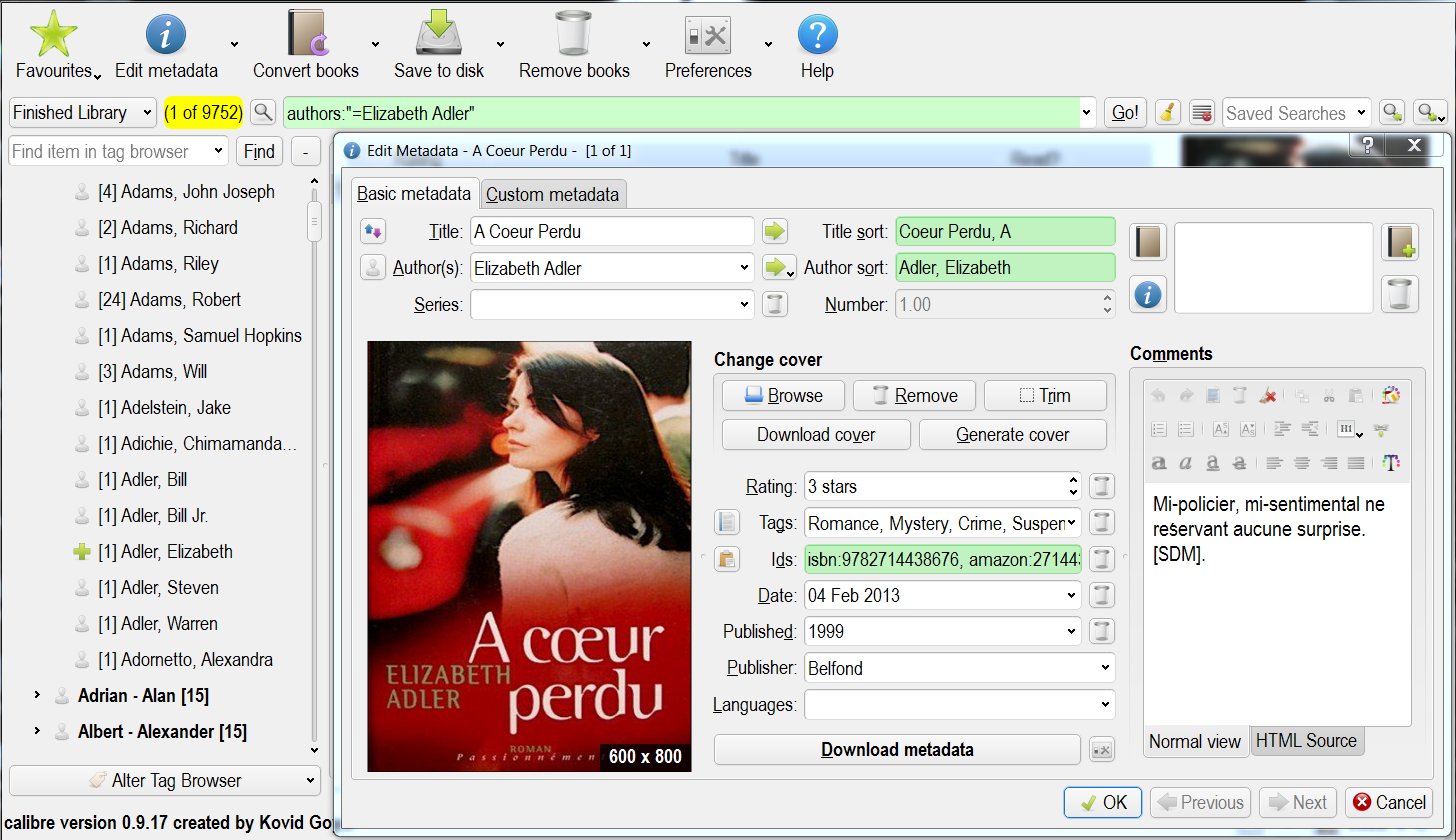

Old 02-05-2013, 12:12 AM   #4
Posts: 46,069
Karma: 29579912
Right click on Elizabeth Adler in the Tag browser and select Edit sort for Elizabeth Adler. That will allow you to edit how the name is sorted. And if you want the sort value displayed in the Tag Browser use the tweak DoctorOhh pointed out.
