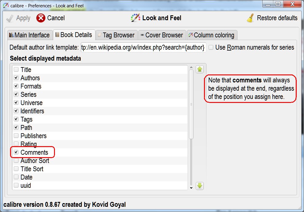

BTW, I was surprised to find longtext custom columns can appear in the Book List, even though Comments can't, is that by design or by chance. If by design then why exclude Comments ?
By Book List are you referring to the Book Details pane? If so comments are not excluded, if selected they just always show up at the end of the pane and can not be moved within the Book details pane.

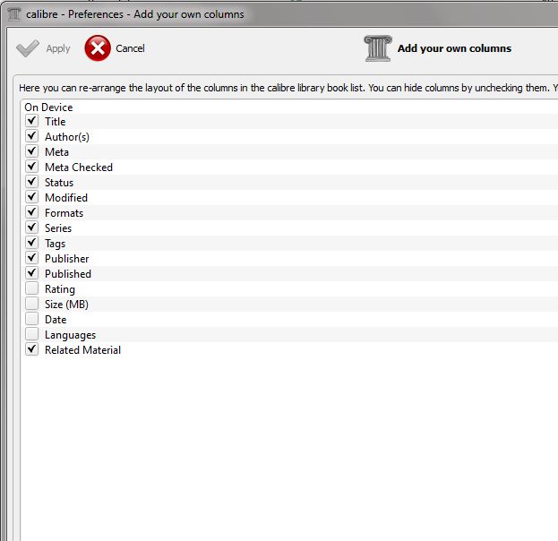

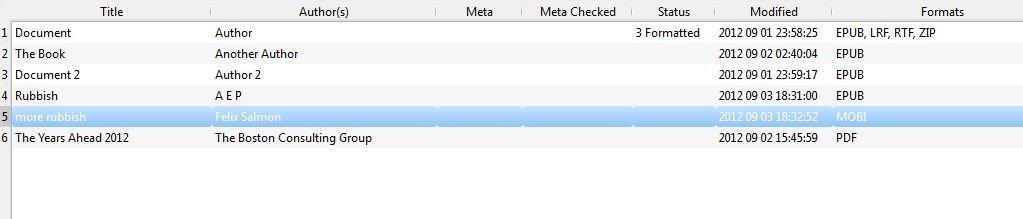

Whew - you had me worried momentarily - I mean the Book List, the panel in the middle, order specified in Define Columns - see piccies
Comments, a predefined longtext column, must go at the end of book details, but custom longtext can go anywhere I please, except after Comments
ID:	91746   Click image for larger version
