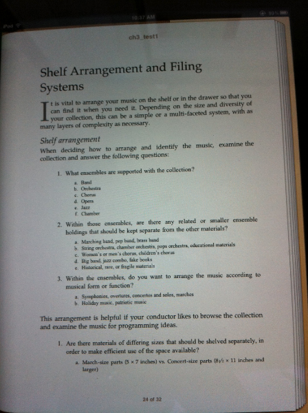

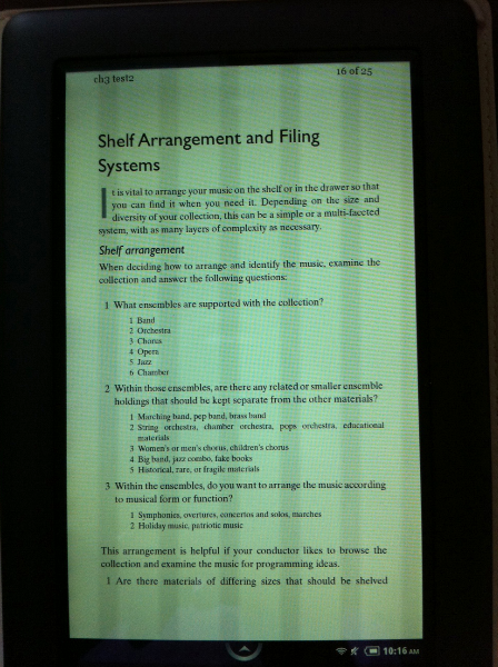

However, there is one specific problem I’m having when viewing the book on a NOOK Color and in the Kindle.app. It's a problem with ordered lists. In this book, there are some outline-style lists, with levels 1. and a. When I edit the EPUB in Sigil to maintain the <ol type="1"> and <ol type="a"> of these lists, they display properly on the iPad and the iPhone. But on the NOOK Color and in the Kindle.app, both lists are still showing up ordered as 1., with the a. level indented properly, styled properly, but not ordered a.
The sample nooklists.JPG.png is the way the page looks on the NOOK Color (incorrect).
The sample ipadlists.JPG.png is the way the page looks on the iPad (correct).
Does anyone have any advice about this? This is really the single thing I'm having problems with now, and it seems illogical that it isn't functioning!
Thanks in advance.

What you can try, is specifying the following in the stylesheet:
ol.loweralpha {
 list-style-type: lower-alpha;
and then use <ol style="loweralpha"> instead of type.
Old 09-11-2011, 10:56 AM   #3
DiapDealer
DiapDealer's Avatar
Posts: 28,914
Karma: 207182180
I can't vouch for the Nook, but the "type" attribute is not supported for the <ol> tag on the Kindle according to the Kindle Publishing Guidelines document. Nor are multi-level lists, for that matter.
EDIT: to clarify... a multi-level list will indent fine, but you can't get a list to show anything but numbers using the <ol> tag on a Kindle.

I included the code for ol.loweralpha in my stylesheet as directed, and when I replaced <ol type="a"> with <ol class="loweralpha">, the lettered lists displayed perfectly on the NOOK Color and on the iPad -- a great solution.
However, as DiapDealer pointed out, these kinds of multilevel lists aren't supported on the Kindle, so the choice is either to have lists with the same "type" of ordering, differentiated only by indents, or (the option I will go with) an unordered list below the ordered list, as the next level, on the Kindle. Because so many ordered lists in original manuscript should technically and logically be unordered lists (in my experience), this isn't as much of a stretch as you might think.
But, I am very grateful to know that I can have lettered lists when necessary, and that when the Kindle does support the "type" attribute for the <ol> tag, I'll already know what to do!
