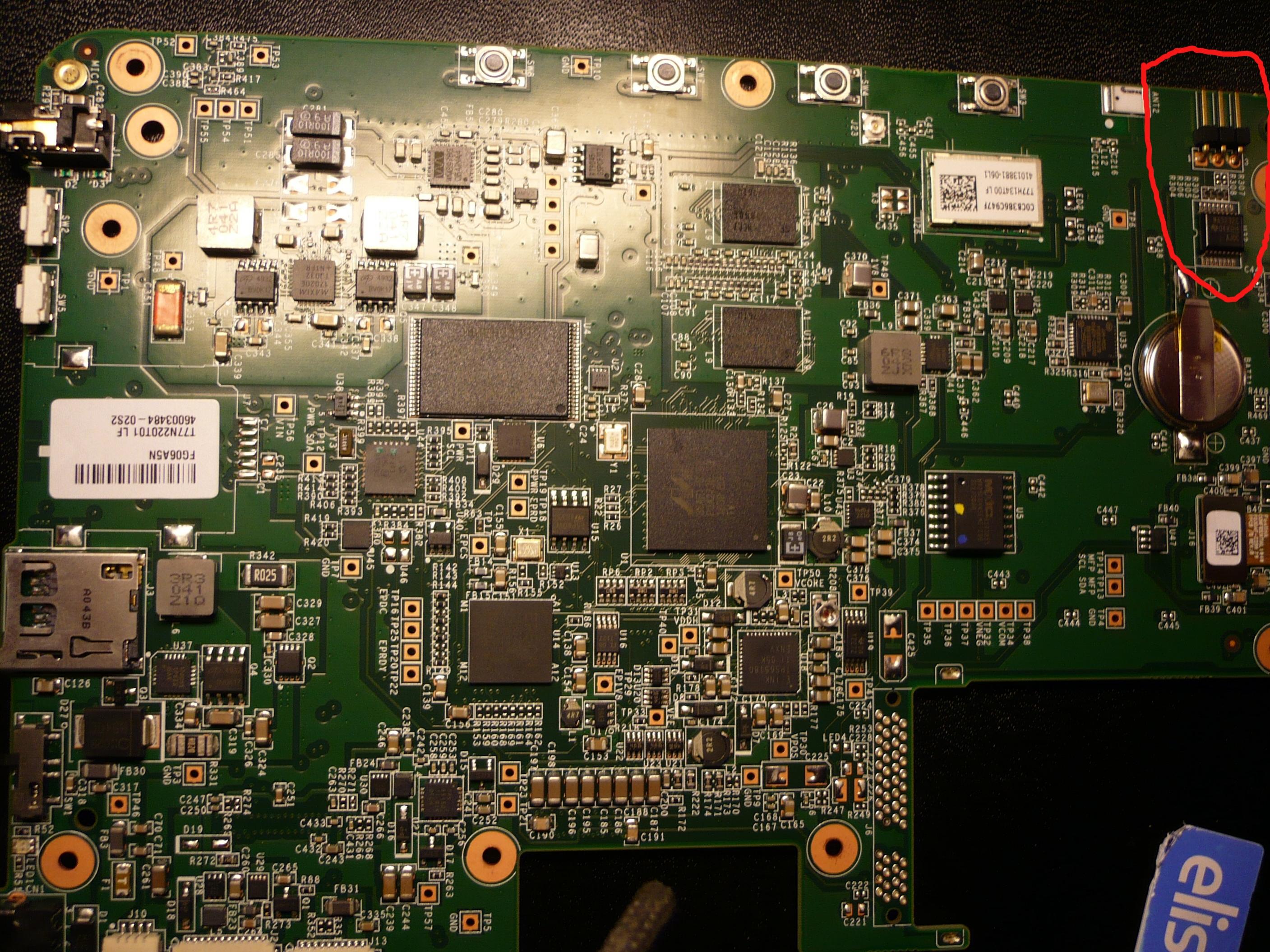

Just opened my WSOD PE to look for the heat source that caused WSOD.
I took some pictures from the components and found debugging serial port that is jused for linux main console.
Check attched picture, serial port marked with red circle.
Here's also output from the serial console:

[ 58.598472] wlan_sdio mmc1:0001:1: firmware: requesting
mrvl/helper_sd.bin
[ 58.674753] init: untracked pid 6319 exited
[ 58.688456] wlan_sdio mmc1:0001:1: firmware: requesting mrvl/sd8688.bin
[ 58.945935] init: untracked pid 6325 exited
[ 59.193335] pxa168fb resuming...
[ 59.199798] kernel/power/earlysuspend.c at line 165:
request_suspend_state new_state = on
[ 59.223019] request_suspend_state: wakeup (3->0) at 59217449854
(2011-08-04 09:47:17.844467076 UTC)
[ 59.504561] WLAN FW is active
[ 59.782073] [tsc2007write_state] entered, new_state 1
[ 59.794115] drivers/input/touchscreen/tsc2007.c at line 399:
turn_on_esi_touchscreen lockstate = 0
[ 65.032243] init: sys_prop: permission denied uid:7000
[ 96.260014] _pxa168fb_suspend(): state = 7] _pxa168fb_suspend(): state =
2.
): state = 2.
[ 96.268718] kernel/power/earlysuspend.c at line 165:
request_suspend_state new_state = mem
[ 96.277045] request_suspend_state: sleep (0->3) at 96271592930
(2011-08-04 09:47:54.898610152 UTC)
[ 967] _pxa168fb_suspend(): state = 2.
[ 116.005474] PM: Syncing filesystems ... done.
[ 116.086083] PM: Preparing system for mem sleep
[ 116.094118] Freezing user space processes ... (elapsed 0.00 seconds)
done.
[ 116.106348] Freezing remaining freezable tasks ... (elapsed 0.00 seconds)
done.
[ 116.114006] PM: Entering mem sleep
[ 116.168123] Suspending console(s) (use no_console_suspend to debug)

JTY, could you please take more pictures and if possible use a couple of lights - on either side of board to remove the glare an evenly light everything. I'm trying to build a list of what components are used. Thanks in advance.
ivanjt is offline   Reply With Quote
Old 08-06-2011, 08:06 AM   #3
JTY
JTY began at the beginning.
Posts: 20
Join Date: Aug 2011
Device: Entourge Pocket Edge
Photos are originally much larger, but the forum software resizes them
I will try and upload them to my own server.
JTY is offline   Reply With Quote

this could be interesting... Try using macro mode as well(if you didn't already), its the one with a flower symbol on most camera's. You can also email me the picture and I can host it if you want.

Originally Posted by JTY View Post
...Here's also output from the serial console...
How was you able to get this data?
Gunnerp245 is offline   Reply With Quote
Old 08-06-2011, 01:46 PM   #6
vicinc
vicinc has a complete set of Star Wars action figures.vicinc has a complete set of Star Wars action figures.vicinc has a complete set of Star Wars action figures.vicinc has a complete set of Star Wars action figures.vicinc has a complete set of Star Wars action figures.
Posts: 733
Karma: 443
Join Date: May 2011
Device: Pocket Edgex2(1unborked), Alex, Nook B&W, Nook Color, Nook STR
so we may have a jtag?
vicinc is offline   Reply With Quote
probably by using a serial cable with his PC and then using a terminal like minicom or similar to read the output...
emusan is offline   Reply With Quote
No jtag, just plain old rs232 protocol
Just plug RX TX to the pin header, there is a MAX232 behind that pin header.
It's configured for 115.2kbps speed, i used minicom because it's the best
Via system console you can do some cool things, full access to u-boot and kernel parameters, you can even load own kernel etc.
But the best part is the kernel boots msg, there's lot of usefully information.
btw. there waas jtag pins on the motherboard for processor debugging
But still no clue what's causing WSOD.

can you get a rom dump please? and try to get recovery around this?

can you identify the jtag pins for us. somebody was asking for those.

is this one of the avengers lite cheap motherboards?
