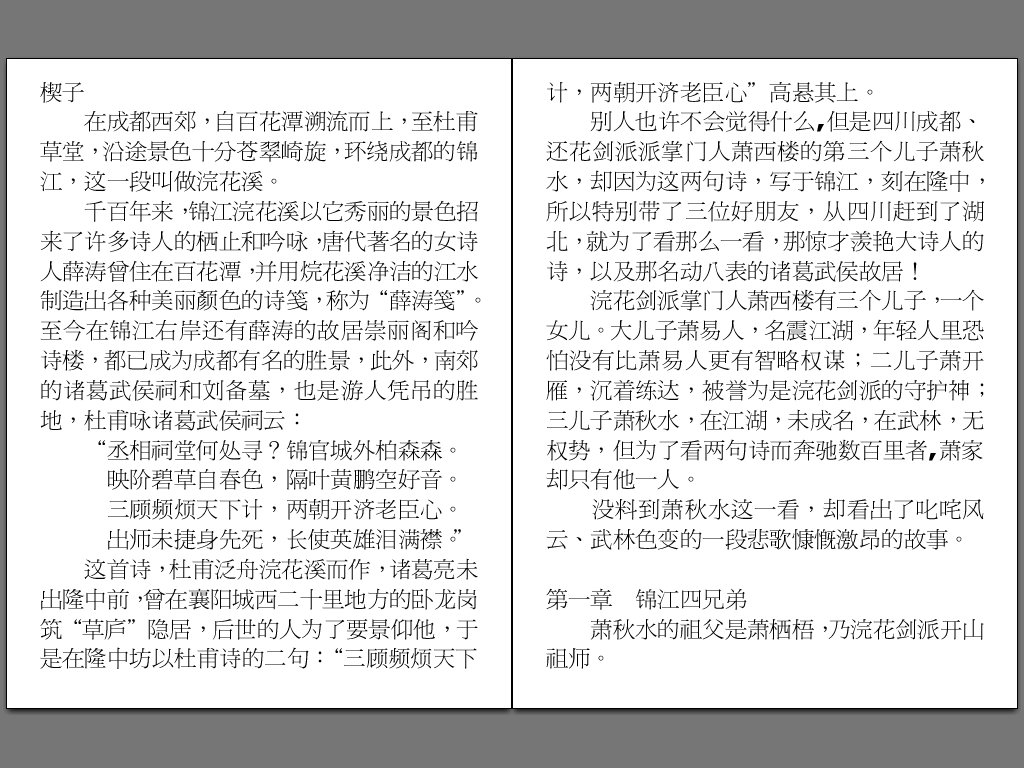

Can you guys test this file? I use pdfFactory to make it, and use 120x90mm size, embed chinese font in the file... Just want check if it works well, I plan buy it in next week anyway.
It works fine in the Connect Software (I don't have time to pop it on my Reader just this moment -- I don't have it handy ), and the ConnSoft is usually a good guide of what will work on the Reader itself -- the only funky thing is that the ConnSoft makes fonts look bigger than they are on the Reader.
It look nice Thanks NatCh
Is the font big in reader? I think smaller font than this can be readable?
