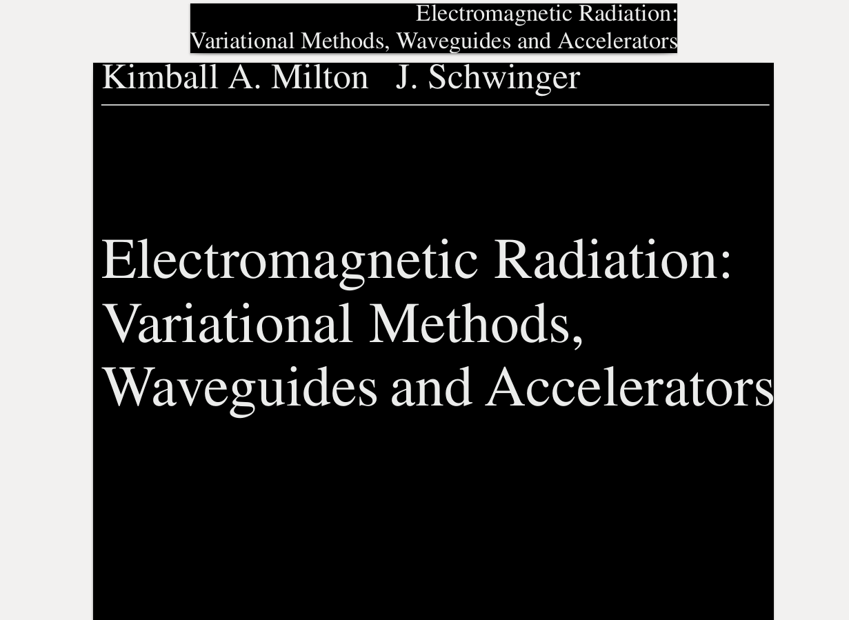

Howto rescale page without changing the resolution of embedded images?
Thank you for this great software!
If I use
k2pdfopt -n -wrap- -mode tm
or
k2pdfopt -wrap- -mode tm
is it possible to rescale the pages to a common width without changing the resolution of the embedded images?
For example I would like the above options plus rescale all pages to a common width of 7 inch.
Right now the unscaled pages look in my pdfreader like in the attachment.

This should be possible. You want to keep the output in native mode so as not to change the resolution of your embedded PDF images. I would simply set your device output to 7 inches x XX inches and use -mode fitwidth. I'm not sure if that's exactly what you want. E.g. maybe
k2pdfopt -h 10in -w 7in -mode fw -ls- mysource.pdf
You could also try it with -mode trim or -mode fitpage instead.
Edit: On second thought, don't use -mode trim--it resets the page size of each page to be whatever the trimmed source content size is.
