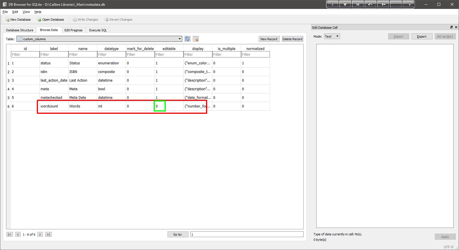

I just noticed that I couldn't edit my #wordcount column in the book list for my three primary libraries (_Main, _Journals and _Media). When I hit tab in the column to the left of #wordcount I would drop out of edit mode When I went into the MDE dialogue the #wordcount columns were absent.
So I looked into custom_columns table in the three databases, and I wasn't surprised to find the #wordcount editable column had a value of '0'.
I can just about believe I might have changed this in one library database at some time, most likely my _Test Library database, but in my three primary libraries... hardly
Normal service, i.e. ability to tab through the #wordcount column in the book list in edit mode, was resumed once I changed the editable cell for #wordcount to '1'
So my question is: was the plugin changed to set the editable column in the custom_columns table to 0 for the #wordcount custom column? Because that's the only explanation for the strange phenomenon I can come up with
For many people it wouldn't be a bad idea to make the columns Count Pages populates non editable. But it should be configurable, because it wouldn't suit everyone.

BR: I don't know how it happened, but it wasn't the Count Pages plugin. The only thing about the columns used by the plugin that it touches is the value.
Old 04-30-2017, 04:01 AM   #1073
Posts: 21,895
Karma: 30277270
@davidfor - I didn't really think it was CP because I haven't installed a new version, or prodded it in any way since 2017-01-22. I don't do a lot of MD editing in those libraries, occasional corrections or gap filling.
But why those three libraries and not my _Intake library (where most of the counting is done), or moreover my _Test Library which is an overweight dog's breakfast on steroids.
I mainly posted just in case someone else runs into a similar issue. It's easily fixed - assuming one knows about editable.
