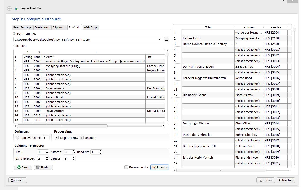

<Next> Button greyed out
I am a little confused - have exported a 4000 item book list and imported without problems into the plugin. Now that everything is ready I see that the <NEXT> button is greyed out. See attached jpg. German version here.
Did I forget something to finish? Thanks for any help...
The first post states:
  • Supports importing title, author, series, series index and pubdate (all but title are optional)
A lot of your items are missing a title. Maybe that's why the Next button is disabled?
trying is offline   Reply With Quote

O.K. - found out that I can handle a smaller csv file (I took 25 items to import). That worked. Does anybody know how long the list of items can be? I have a file with 4000 titles to import !
You (still) have blanks in the title column on the right side
Title is required, Always

You are completely right! Just eliminated the blanks ... and my setup is running now - thanks all!
