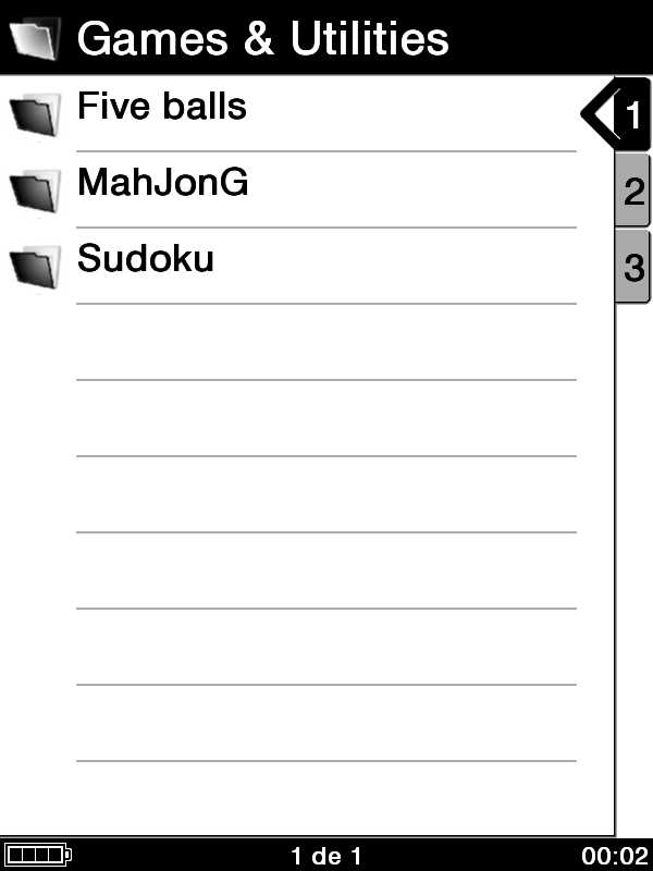

Originally Posted by kartu View Post
surquizu
Depends on the game actually, but rather easy. You have 2 options
1) examine the sources, namely sudoku.js and corresponding folder content and suggest your own patch to add the mentioned games
2) paste links to the games and I'll integrate them myself (can't promise that it will be today or tomorrow, but rather sooner than later)
thanks, I made it.

Nice. I can add you to developer list, so that you could commit the code yourself, if you want. (you'd need google account)
