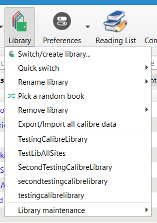

Unrelated New Issue:
In the GUI, if I switch to a library that I have open in a browser (currently or previously?--not sure), I end up with a second, all lowercase entry for the same library. Those remain even after switch back to 2.85 and have to be removed manually:

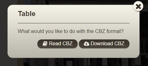

I added a format file to an existing book, it didn't appear on the running server. It did appear after I installed a new version of Chrome, but I assume that was a red herring
I recall seeing a message referring to the need to refresh the server 'cache' (or something similar), I think that was after installing a new version of the beta. My questions are:
What triggers the refresh? Can something be added to Settings to force a refresh. Or would a Library switch do the trick?
Any chance of adding a third choice, Open in default handler (perhaps for non-EPUB formats only), to:

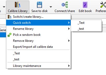

I've found a 'fix' for this. Some googling lead me to this FireFox bug comment. I found that my 'storage' dir was dated Feb 2015. Deleting everything in it (with FireFox off, then restart) and IndexedDB started working for me.
I am definitely seeing this. Replicate steps
  • Run GUI
  • Start content server
  • Visit content server web server
  • Enter a library in browser, 'read' a book
  • Return to GUI, switch to any library that has been visited in the running content server
  • The library switched to will an all-lowercase named version and both will now appear in your library list.
I don't have any libraries without uppercase, so I don't know what happens then.
  • Run GUI
Confirmed
I've visited and read books in both the Calibre Library and the _Test libraries, but it seems only the _Test library ever gets lower cased, couldn't make it happen with the Calibre Library

@BR: Doesn't Download book do that already? As far as I know there is no way to open files in a program on the local computer from within a webpage.

@JimmXinu: This should fix the library name issue, however, I currently dont have access to a windows machine to test, so I'd appreciate it if you could let me know if it works:
https://github.com/kovidgoyal/calibr...6d690906bb9002

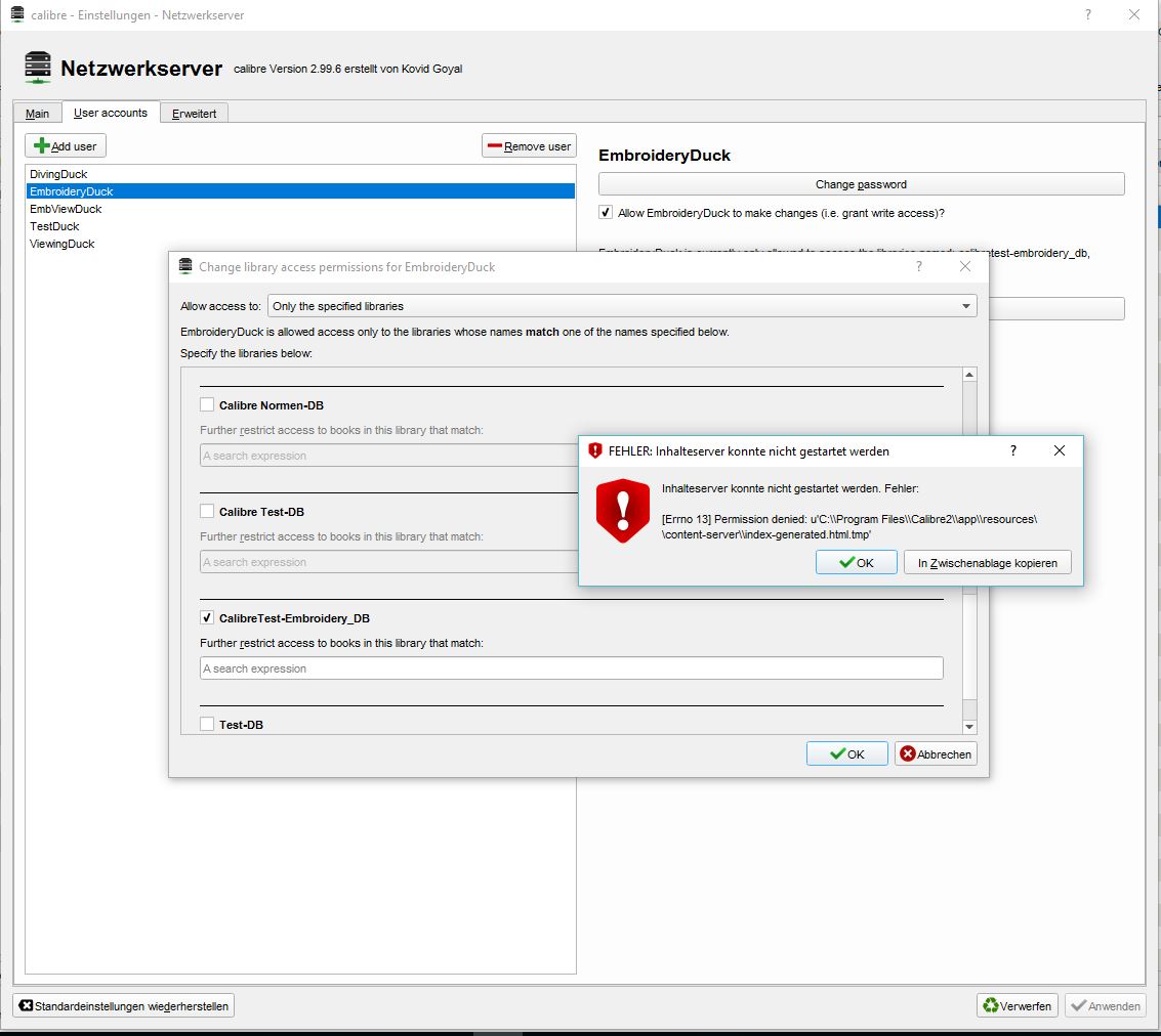

I just run calibre from actual source (dl 10 minutes ago):
calibre, version 2.99.6
FEHLER: Inhalteserver konnte nicht gestartet werden: Inhalteserver konnte nicht gestartet werden. Fehler:
[Errno 13] Permission denied: u'C:\\Program Files\\Calibre2\\app\\resources\\content-server\\index-generated.html.tmp'
The GUI starts normal (automatically start server checked) and I went to servers preferences and short time late I got this message w/o server start.

That's odd, can you run calibre in debug mode and post the log
