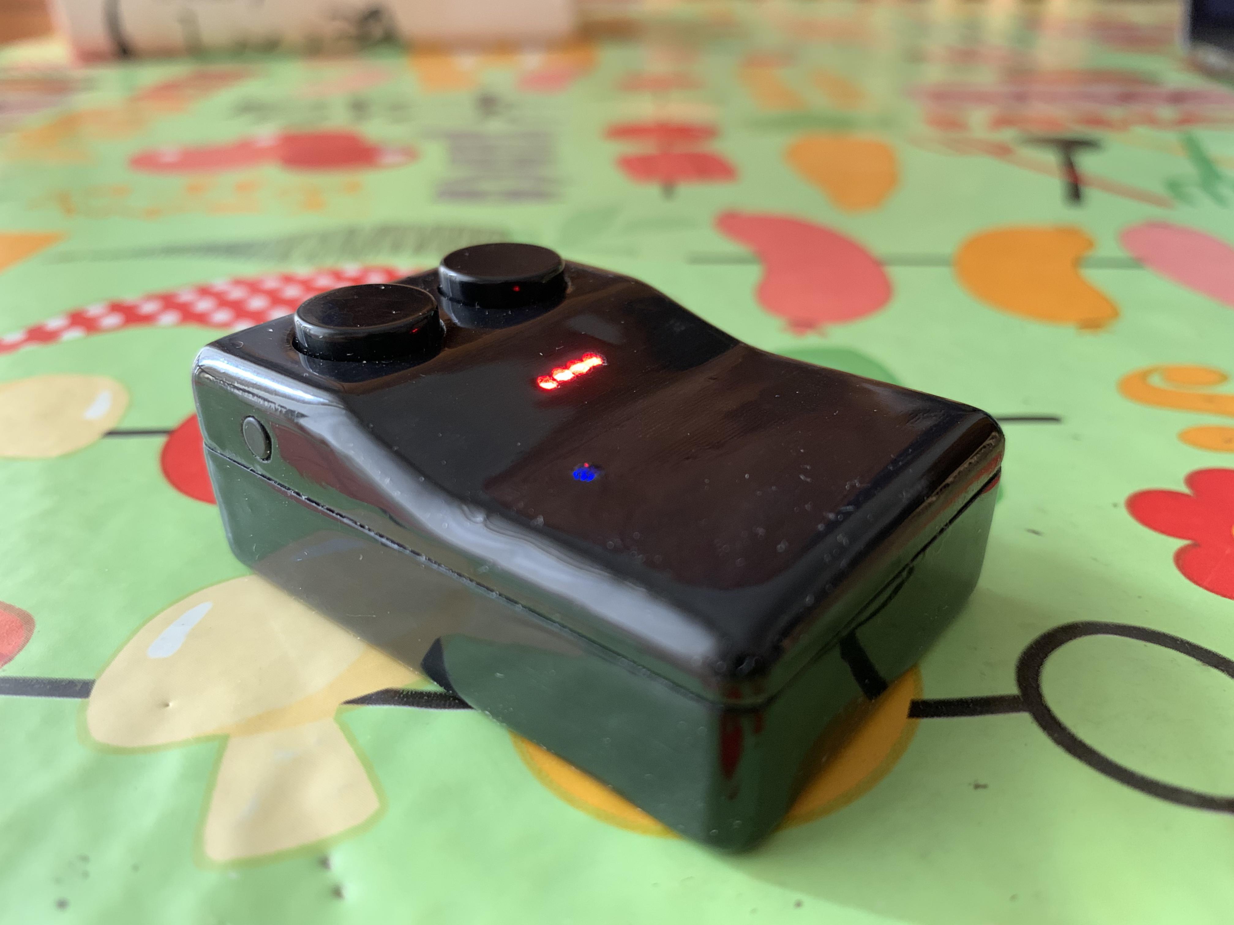

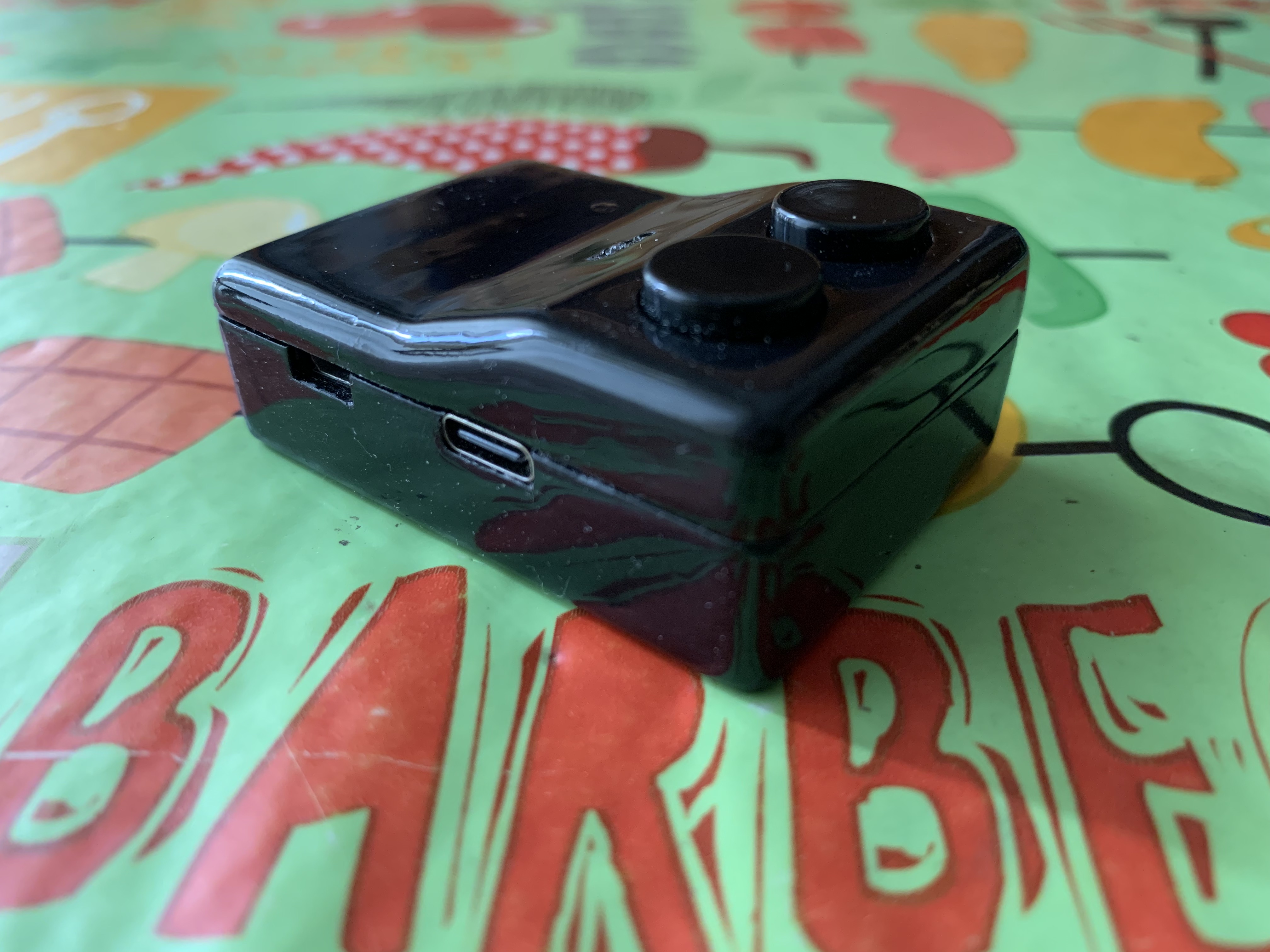

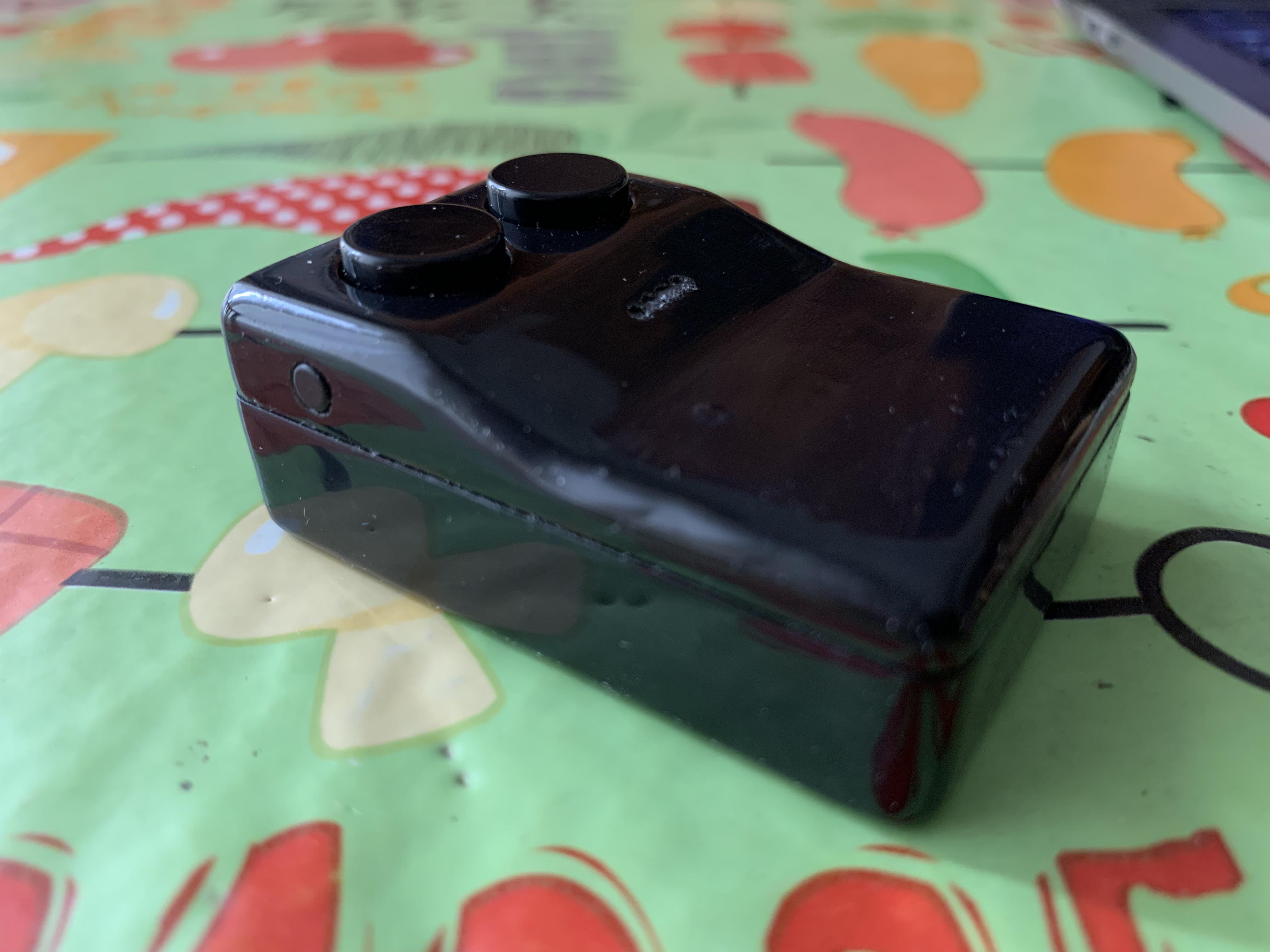

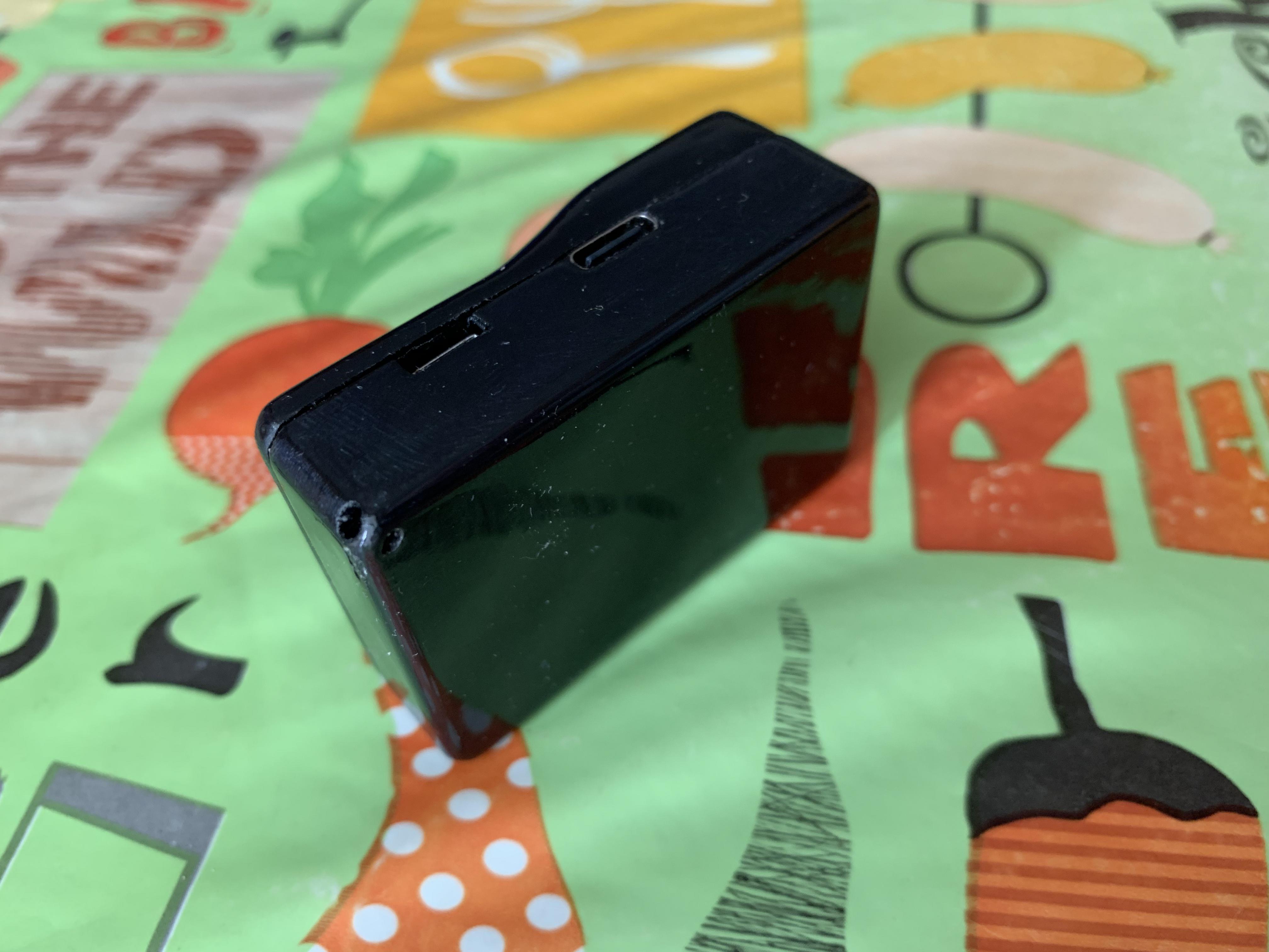

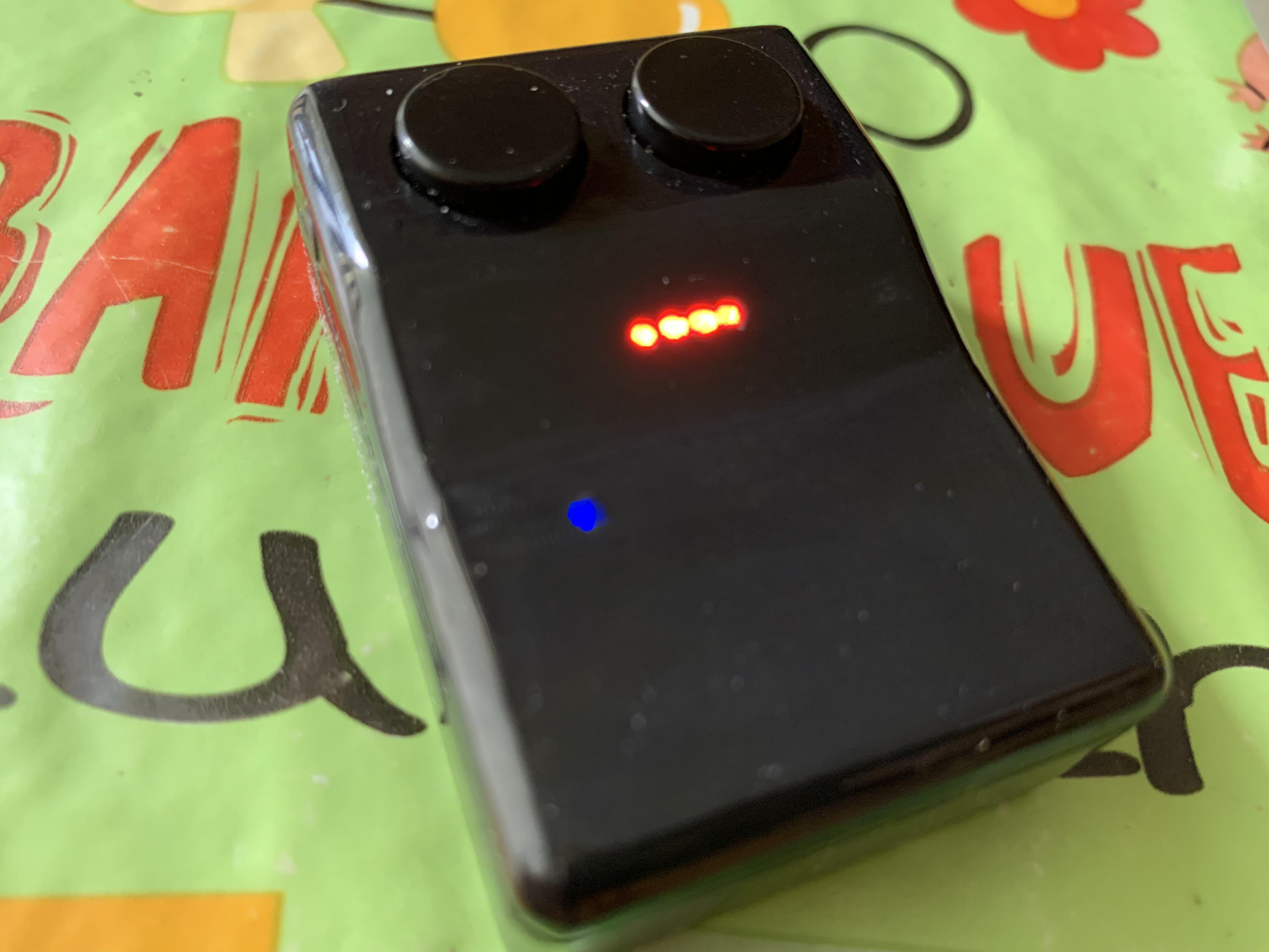

I did it!
  • Next/Previous top buttons
  • Bookmark (simultaneous pressure)
  • Side power button
  • Status leds for battery level (red) and events (blue)
  • Upgradable software (micro-usb)
  • 1100mAH rechargeable battery (usb-c)
  • Timed standby upon disconnect (1min)/idle (15min)
  • Lanyard hole
  • No smartphone required!
  • 3d printed box with UV resin coating finish
  • 39x56x17-23mm - 44g
