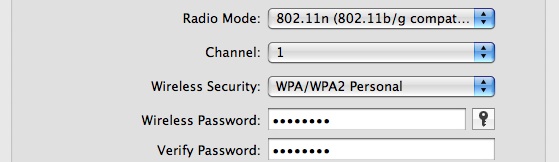

I am having major issues with my new Nook WIFI also ... I bought one this afternoon and could not get it to connect to my home network ... I called tech support & after an hour, their suggestion was to exchange it for another one. I did .. came back home and went through the process again. I could NEVER get it to register, however, I COULD get online through the browser. I went back to the store and we were able to get it to register there. After coming back home ... I am experiencing the same problems. I can browse web sites, connect to the store and so on, however when I try to make a purchase, I get a message that says "Processing your order" ... this lasted for almost a half hour and it never actually completes the purchase.
So something else is wrong ... I am using an Apple Airport Extreme base station and it's working with no problems ... my Macbook and iPhone are able to connect without any problems. I've tried different security options on my base station, without luck so far. I even tried connecting to my neighbor's network, however, the signal strength was pretty low and it did not work.
Any suggestions? This is driving me crazy

Sounds like there is something wrong with your B&N account.
Do you have a valid credit card registered in your account? And have you made that credit card the default credit card?
Try buying an e-book on the B&N website (just test a free e-book). Does that work?

Oh, all of my information was set up properly... I've been using the account for years from BN.com without any problems and I double-checked everything when I was trying to set up the nook the first time. It appears to be a problem with the nook software itself. Hopefully the developers will work out these issues in a future update.
